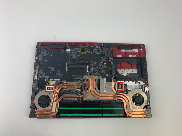

  4. MSI GP62MVR 6RF Leopard Pro Fans Replacement, Fans: crwdns2935265:04crwdnd2935265:01crwdnd2935265:02crwdne2935265:0 MSI GP62MVR 6RF Leopard Pro Fans Replacement, Fans: crwdns2935265:04crwdnd2935265:02crwdnd2935265:02crwdne2935265:0

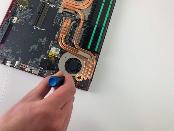

    • Remove the eight 4.5 mm screws that hold the heat sink to the motherboard with a Phillips #0 screwdriver.
    • Remove the four 4.5 mm screws holding the fan in place also using a Phillips #0 screwdriver.
    • Watch for the screw hidden under the wires highlighted in the second picture.
  5. MSI GP62MVR 6RF Leopard Pro Fans Replacement: crwdns2935265:05crwdnd2935265:01crwdnd2935265:02crwdne2935265:0 MSI GP62MVR 6RF Leopard Pro Fans Replacement: crwdns2935265:05crwdnd2935265:02crwdnd2935265:02crwdne2935265:0
    • Disconnect both power cables for the fans.
    • Make sure to pinch the power cables. It may require a bit of force.

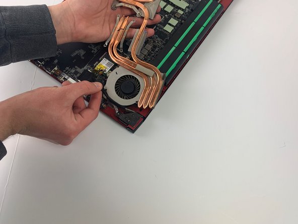

    • Using the Jimmy tool, remove the adhesive pads securing the fans to the board.
  7. MSI GP62MVR 6RF Leopard Pro Fans Replacement: crwdns2935265:07crwdnd2935265:01crwdnd2935265:01crwdne2935265:0
    • Remove the black adhesive.
  8. MSI GP62MVR 6RF Leopard Pro Fans Replacement: crwdns2935265:08crwdnd2935265:01crwdnd2935265:01crwdne2935265:0

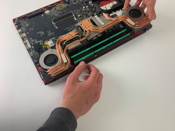

    • Separate the heat sink from the tab on the side holding the fan in place.
  9. MSI GP62MVR 6RF Leopard Pro Fans Replacement: crwdns2935265:09crwdnd2935265:01crwdnd2935265:01crwdne2935265:0
    • Remove the three 3.5 mm screws on each fan holding the fan to the heat sink using a Phillips #0 screwdriver.
