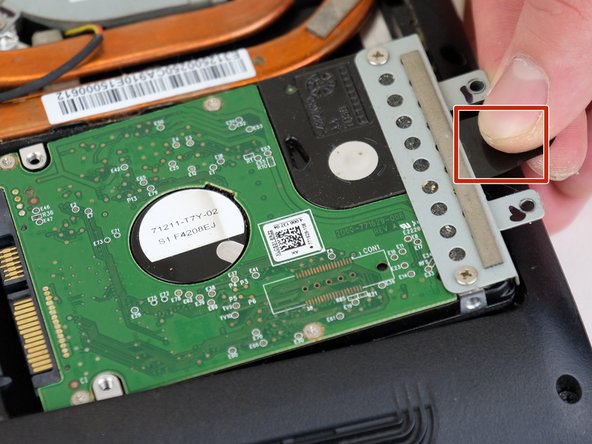

  8. MSI GP60 2PE Leopard Hard Drive Replacement, Hard Drive: crwdns2935265:08crwdnd2935265:01crwdnd2935265:01crwdne2935265:0
    • Remove the two 5 mm black screws on the right hand side with a Phillips #0 screwdriver.
  9. MSI GP60 2PE Leopard Hard Drive Replacement: crwdns2935265:09crwdnd2935265:01crwdnd2935265:03crwdne2935265:0 MSI GP60 2PE Leopard Hard Drive Replacement: crwdns2935265:09crwdnd2935265:02crwdnd2935265:03crwdne2935265:0 MSI GP60 2PE Leopard Hard Drive Replacement: crwdns2935265:09crwdnd2935265:03crwdnd2935265:03crwdne2935265:0
    • Lift the hard drive, then remove from the device. There is a black strip of plastic attached to make the process easier.
