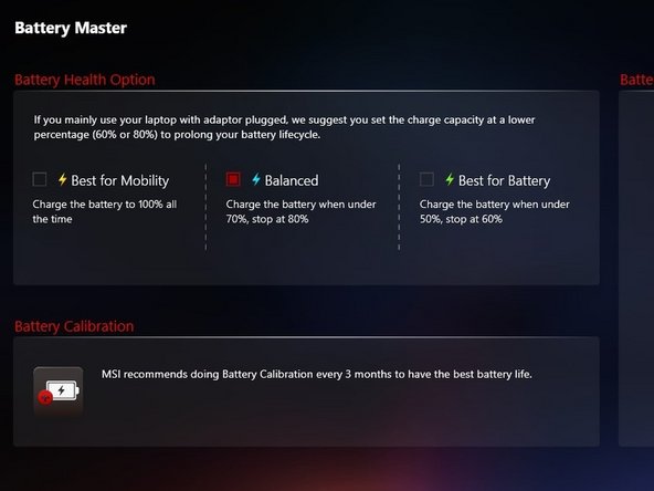

    6. MSI GF65 10UE Battery Replacement, Battery Calibration (Non Essential): crwdns2935265:06crwdnd2935265:01crwdnd2935265:02crwdne2935265:0 MSI GF65 10UE Battery Replacement, Battery Calibration (Non Essential): crwdns2935265:06crwdnd2935265:02crwdnd2935265:02crwdne2935265:0
      • To get the best performance and statistics toward the capacity of this battery on your system, you should make the use of the built in dragon center to ensure the battery is properly calibrated.
      • Furthermore, making sure the battery is recognised by windows be sure to check the power & battery section in windows settings.
