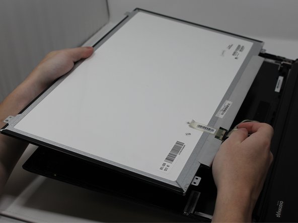

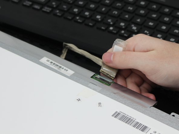

  3. MSI GE72 6QF Apache Pro Screen Replacement: crwdns2935265:03crwdnd2935265:01crwdnd2935265:03crwdne2935265:0 MSI GE72 6QF Apache Pro Screen Replacement: crwdns2935265:03crwdnd2935265:02crwdnd2935265:03crwdne2935265:0 MSI GE72 6QF Apache Pro Screen Replacement: crwdns2935265:03crwdnd2935265:03crwdnd2935265:03crwdne2935265:0
    • Flip the screen over and carefully peel off the tape that holds the connector in place.
    • When peeling off the tape, fold it back so that it can remain sticky for the new screen.
