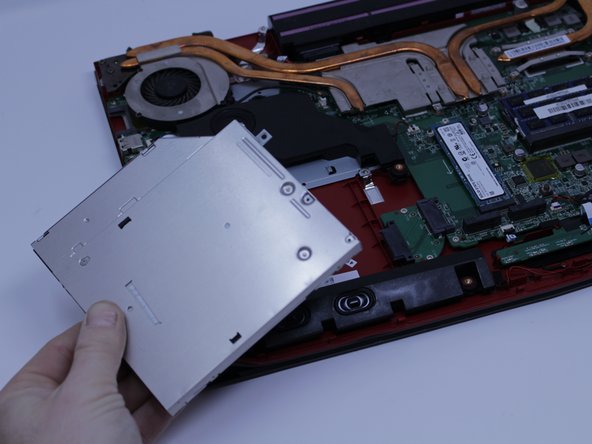

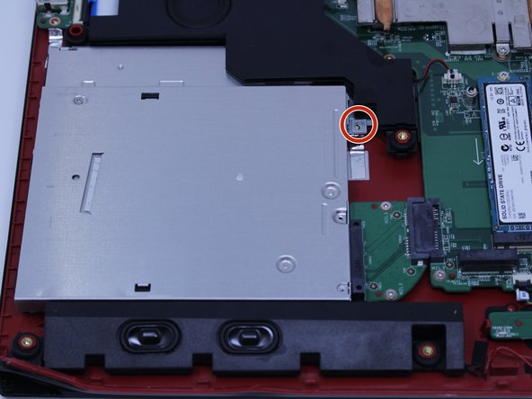

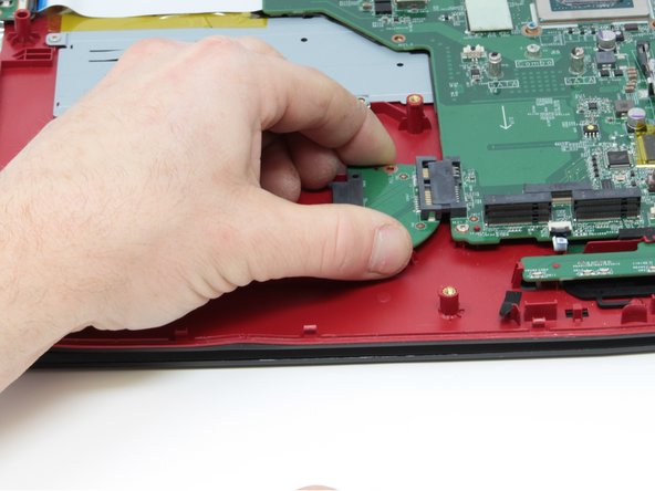

  14. MSI GE72 6QF Apache Pro Keyboard Replacement, Optical Drive: crwdns2935265:014crwdnd2935265:01crwdnd2935265:03crwdne2935265:0 MSI GE72 6QF Apache Pro Keyboard Replacement, Optical Drive: crwdns2935265:014crwdnd2935265:02crwdnd2935265:03crwdne2935265:0 MSI GE72 6QF Apache Pro Keyboard Replacement, Optical Drive: crwdns2935265:014crwdnd2935265:03crwdnd2935265:03crwdne2935265:0
    • Carefully slide the Optical Drive off of the SATA connector.
    • The red marker shows the location for where the retaining screw comes through the back panel to hold the Optical Drive.

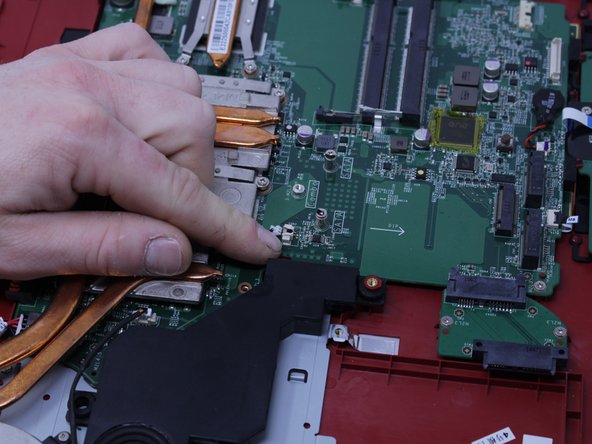

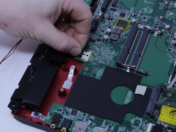

  20. MSI GE72 6QF Apache Pro Keyboard Replacement, Motherboard: crwdns2935265:020crwdnd2935265:01crwdnd2935265:03crwdne2935265:0 MSI GE72 6QF Apache Pro Keyboard Replacement, Motherboard: crwdns2935265:020crwdnd2935265:02crwdnd2935265:03crwdne2935265:0 MSI GE72 6QF Apache Pro Keyboard Replacement, Motherboard: crwdns2935265:020crwdnd2935265:03crwdnd2935265:03crwdne2935265:0
    • Pull upward to lift the front speakers and sub-woofer out of place.
    • Carefully slide out the connectors for both of the speaker systems.

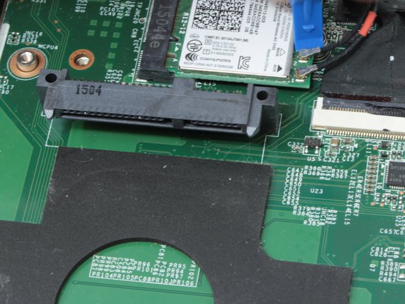

  21. MSI GE72 6QF Apache Pro Keyboard Replacement: crwdns2935265:021crwdnd2935265:01crwdnd2935265:03crwdne2935265:0 MSI GE72 6QF Apache Pro Keyboard Replacement: crwdns2935265:021crwdnd2935265:02crwdnd2935265:03crwdne2935265:0 MSI GE72 6QF Apache Pro Keyboard Replacement: crwdns2935265:021crwdnd2935265:03crwdnd2935265:03crwdne2935265:0
    • Use the Phillips #0 Screwdriver to remove the two 4mm screws that are holding the SATA connector in place.

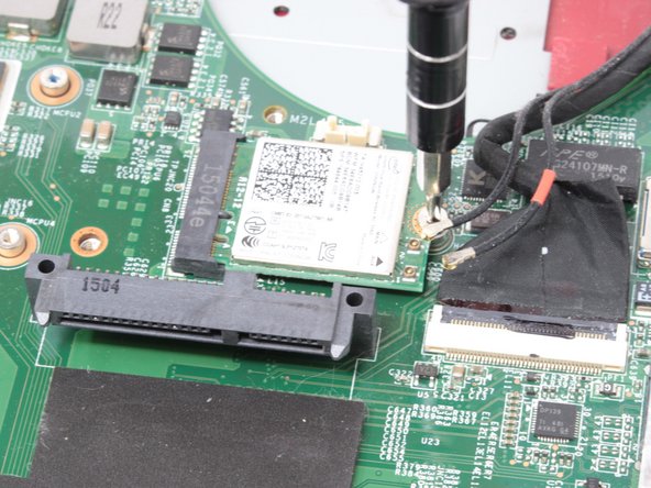

  22. MSI GE72 6QF Apache Pro Keyboard Replacement: crwdns2935265:022crwdnd2935265:01crwdnd2935265:03crwdne2935265:0 MSI GE72 6QF Apache Pro Keyboard Replacement: crwdns2935265:022crwdnd2935265:02crwdnd2935265:03crwdne2935265:0 MSI GE72 6QF Apache Pro Keyboard Replacement: crwdns2935265:022crwdnd2935265:03crwdnd2935265:03crwdne2935265:0
    • Remove the WIFI card by disconnecting the two coax cables and removing the retaining screw.
    • Try to preserve the tape that covers the WIFI card so it can be reapplied.

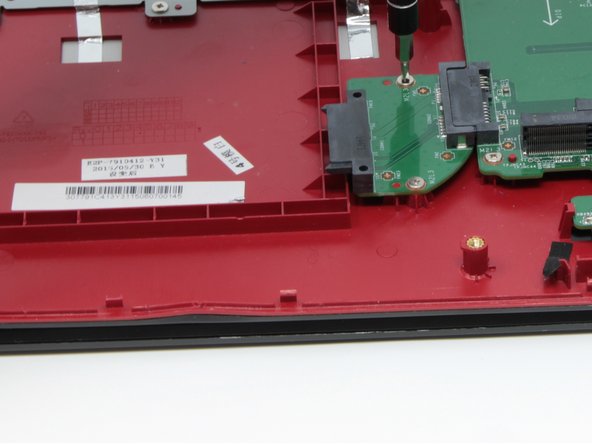

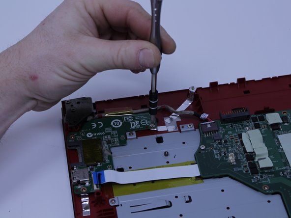

  24. MSI GE72 6QF Apache Pro Keyboard Replacement: crwdns2935265:024crwdnd2935265:01crwdnd2935265:02crwdne2935265:0 MSI GE72 6QF Apache Pro Keyboard Replacement: crwdns2935265:024crwdnd2935265:02crwdnd2935265:02crwdne2935265:0
    • Remove the SD card reader by unscrewing the two 3 mm screws that hold it in place.

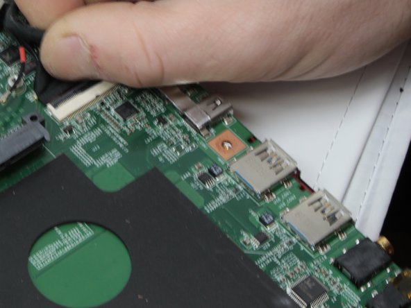

  25. MSI GE72 6QF Apache Pro Keyboard Replacement: crwdns2935265:025crwdnd2935265:01crwdnd2935265:03crwdne2935265:0 MSI GE72 6QF Apache Pro Keyboard Replacement: crwdns2935265:025crwdnd2935265:02crwdnd2935265:03crwdne2935265:0 MSI GE72 6QF Apache Pro Keyboard Replacement: crwdns2935265:025crwdnd2935265:03crwdnd2935265:03crwdne2935265:0
    • Remove the power and USB connectors that are connected to the left side of the motherboard by pulling them from the motherboard and SD card reader respectively.
    • The power connector pulls out without the chance of breaking, but the USB connector is another fragile flip-up style connector.

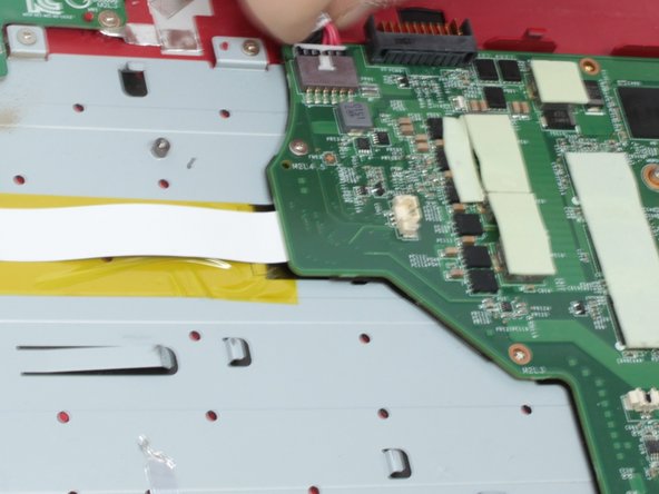

  26. MSI GE72 6QF Apache Pro Keyboard Replacement: crwdns2935265:026crwdnd2935265:01crwdnd2935265:01crwdne2935265:0
    • Disconnect the motherboard from the mouse key control board by pulling the connector out.

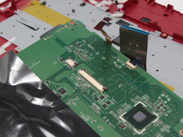

  27. MSI GE72 6QF Apache Pro Keyboard Replacement: crwdns2935265:027crwdnd2935265:01crwdnd2935265:02crwdne2935265:0 MSI GE72 6QF Apache Pro Keyboard Replacement: crwdns2935265:027crwdnd2935265:02crwdnd2935265:02crwdne2935265:0
    • Disconnect the keyboard from the motherboard by carefully sliding the connectors out of the connections on the motherboard

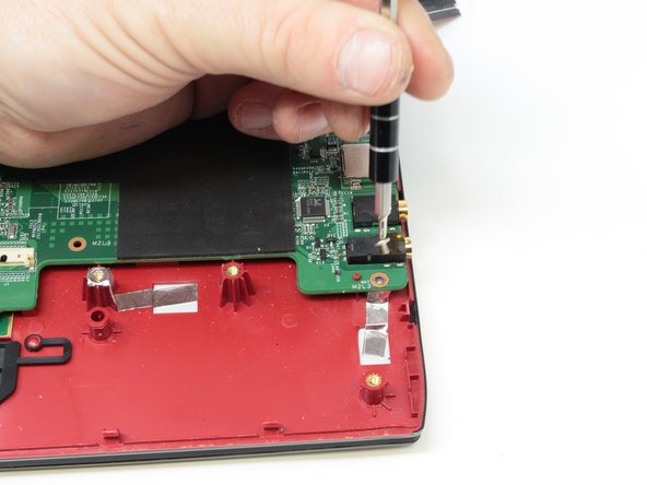

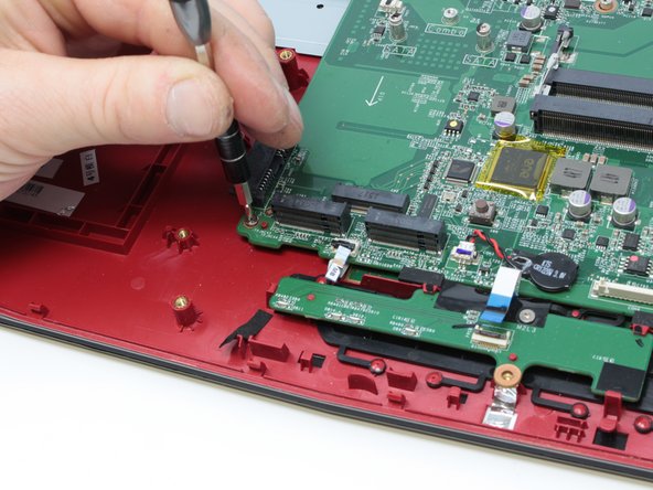

  28. MSI GE72 6QF Apache Pro Keyboard Replacement: crwdns2935265:028crwdnd2935265:01crwdnd2935265:03crwdne2935265:0 MSI GE72 6QF Apache Pro Keyboard Replacement: crwdns2935265:028crwdnd2935265:02crwdnd2935265:03crwdne2935265:0 MSI GE72 6QF Apache Pro Keyboard Replacement: crwdns2935265:028crwdnd2935265:03crwdnd2935265:03crwdne2935265:0
    • Use the Phillips #0 screwdriver to remove the three 3.8 mm standoff screws that retain the motherboard and carefully remove it.

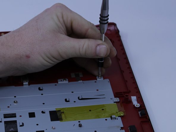

  29. MSI GE72 6QF Apache Pro Keyboard Replacement, Keyboard: crwdns2935265:029crwdnd2935265:01crwdnd2935265:02crwdne2935265:0 MSI GE72 6QF Apache Pro Keyboard Replacement, Keyboard: crwdns2935265:029crwdnd2935265:02crwdnd2935265:02crwdne2935265:0
    • Peel the silver tape off of the keyboard back plate.

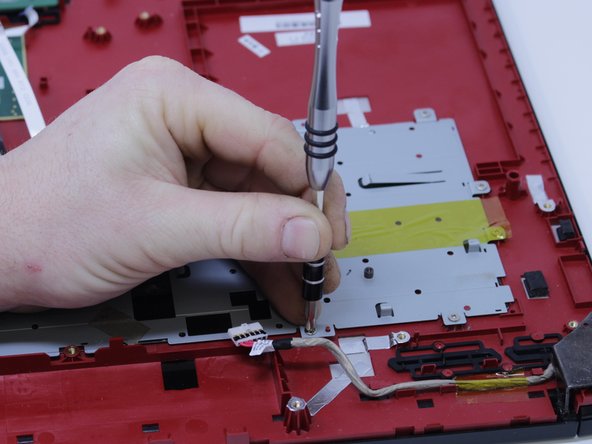

  30. MSI GE72 6QF Apache Pro Keyboard Replacement: crwdns2935265:030crwdnd2935265:01crwdnd2935265:03crwdne2935265:0 MSI GE72 6QF Apache Pro Keyboard Replacement: crwdns2935265:030crwdnd2935265:02crwdnd2935265:03crwdne2935265:0 MSI GE72 6QF Apache Pro Keyboard Replacement: crwdns2935265:030crwdnd2935265:03crwdnd2935265:03crwdne2935265:0
    • Remove the thirteen 3 mm screws that fasten the keyboard in place.
  31. MSI GE72 6QF Apache Pro Keyboard Replacement: crwdns2935265:031crwdnd2935265:01crwdnd2935265:02crwdne2935265:0 MSI GE72 6QF Apache Pro Keyboard Replacement: crwdns2935265:031crwdnd2935265:02crwdnd2935265:02crwdne2935265:0
    • Carefully lift and slide the keyboard out.

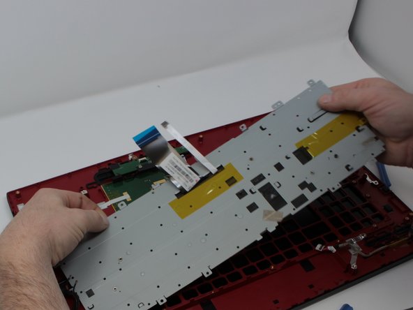

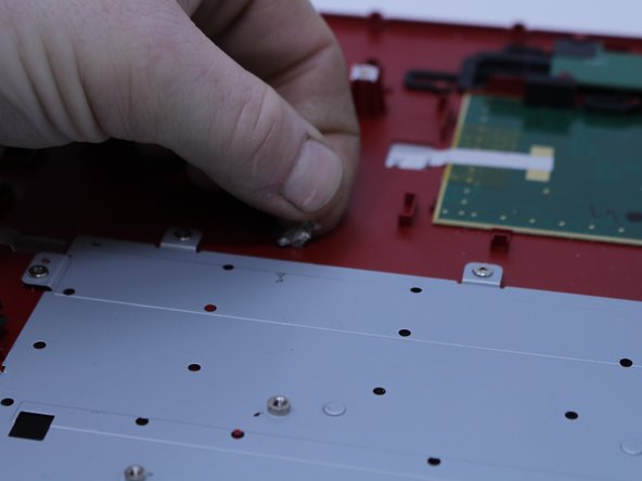

  32. MSI GE72 6QF Apache Pro Keyboard Replacement: crwdns2935265:032crwdnd2935265:01crwdnd2935265:01crwdne2935265:0
    • Peel the yellow tape off of the back plate to free the keyboard so it can be separated from the plate.
    • Preserve this piece of tape so that it can be used when swapping in the new keyboard.
