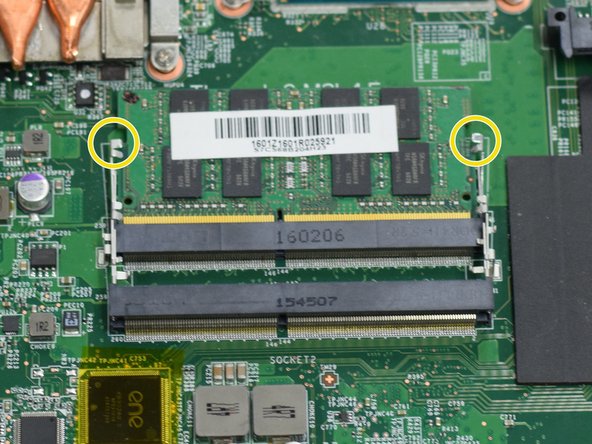

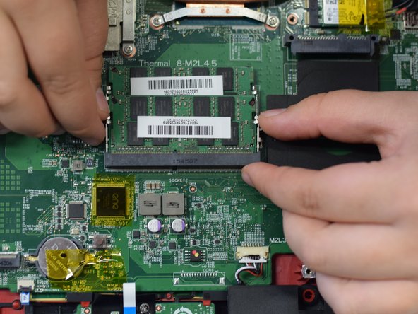

    • Once you have the hard drive removed, we will move onto the RAM. There will be two clasps holding it down.
    • To take out the RAM, push down on the two metal clasps out until the RAM pops up out of place.
    • Repeat this for the second RAM card.
