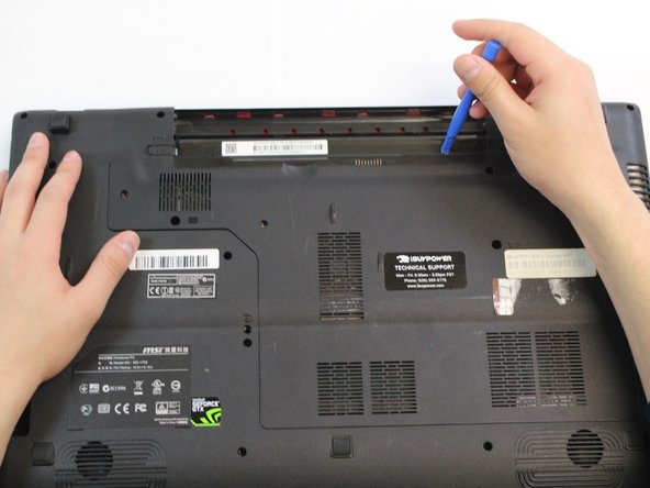

    • Pry the battery upward using the indent.
  5. MSI GE70 2PE Apache Pro Touchpad Replacement: crwdns2935265:05crwdnd2935265:01crwdnd2935265:03crwdne2935265:0 MSI GE70 2PE Apache Pro Touchpad Replacement: crwdns2935265:05crwdnd2935265:02crwdnd2935265:03crwdne2935265:0 MSI GE70 2PE Apache Pro Touchpad Replacement: crwdns2935265:05crwdnd2935265:03crwdnd2935265:03crwdne2935265:0
    • Continue to pull the battery until it is free of the casing.

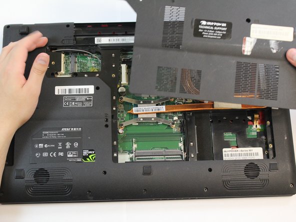

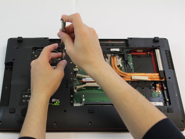

    • Remove the six 5.5mm screws by using a Phillips #1 screwdriver.
    • Pry the door off using a plastic opening tool.
  7. MSI GE70 2PE Apache Pro Touchpad Replacement: crwdns2935265:07crwdnd2935265:01crwdnd2935265:03crwdne2935265:0 MSI GE70 2PE Apache Pro Touchpad Replacement: crwdns2935265:07crwdnd2935265:02crwdnd2935265:03crwdne2935265:0 MSI GE70 2PE Apache Pro Touchpad Replacement: crwdns2935265:07crwdnd2935265:03crwdnd2935265:03crwdne2935265:0
    • Remove the five 3.5mm screws by using a Phillips #1 screwdriver.
  8. MSI GE70 2PE Apache Pro Touchpad Replacement: crwdns2935265:08crwdnd2935265:01crwdnd2935265:03crwdne2935265:0 MSI GE70 2PE Apache Pro Touchpad Replacement: crwdns2935265:08crwdnd2935265:02crwdnd2935265:03crwdne2935265:0 MSI GE70 2PE Apache Pro Touchpad Replacement: crwdns2935265:08crwdnd2935265:03crwdnd2935265:03crwdne2935265:0
    • Remove the twenty-one 5.5mm screws by using a Phillips #1 screwdriver.

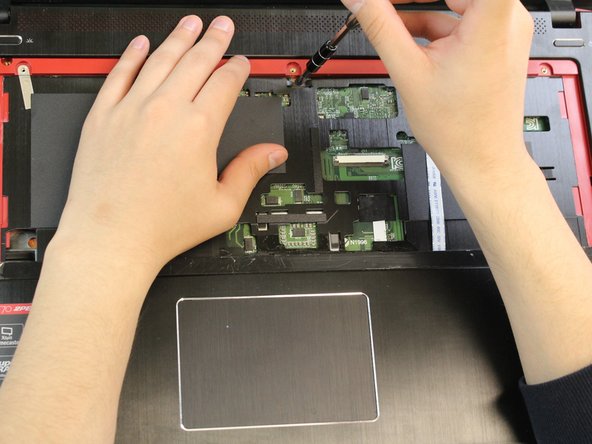

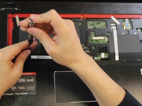

    • Remove the two 5.5mm screws by using a Phillips #1 screwdriver.
  12. MSI GE70 2PE Apache Pro Touchpad Replacement: crwdns2935265:012crwdnd2935265:01crwdnd2935265:03crwdne2935265:0 MSI GE70 2PE Apache Pro Touchpad Replacement: crwdns2935265:012crwdnd2935265:02crwdnd2935265:03crwdne2935265:0 MSI GE70 2PE Apache Pro Touchpad Replacement: crwdns2935265:012crwdnd2935265:03crwdnd2935265:03crwdne2935265:0
    • Disconnect the touchpad, touchpad button, and power board connections.

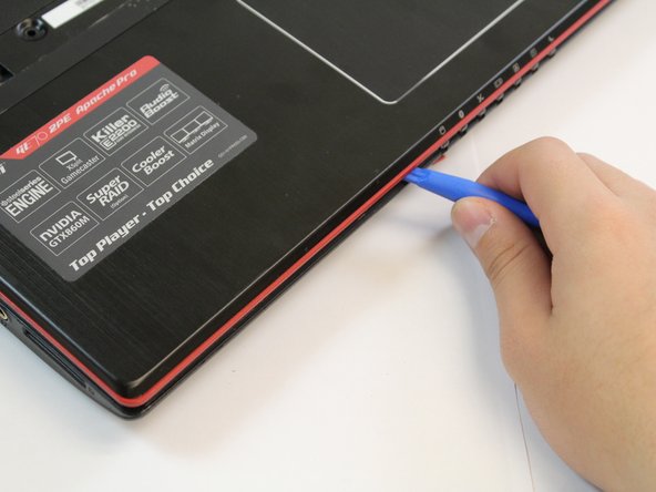

    • Using the plastic opening tool, pry open the computer case.

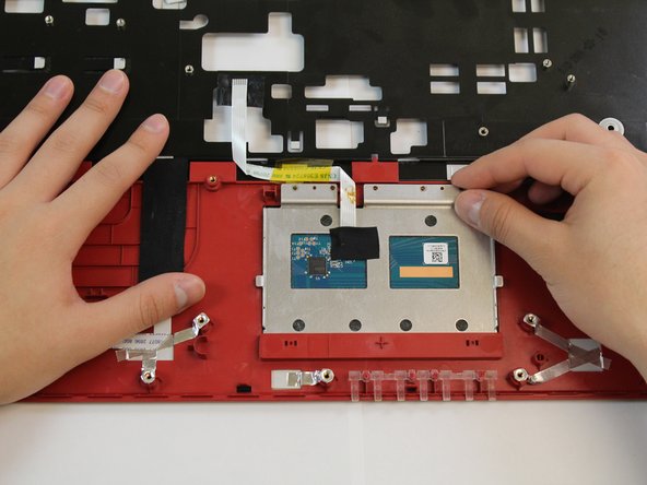

  15. MSI GE70 2PE Apache Pro Touchpad Replacement: crwdns2935265:015crwdnd2935265:01crwdnd2935265:03crwdne2935265:0 MSI GE70 2PE Apache Pro Touchpad Replacement: crwdns2935265:015crwdnd2935265:02crwdnd2935265:03crwdne2935265:0 MSI GE70 2PE Apache Pro Touchpad Replacement: crwdns2935265:015crwdnd2935265:03crwdnd2935265:03crwdne2935265:0
    • Remove the five 2.5mm screws by using a Phillips #1 screwdriver.

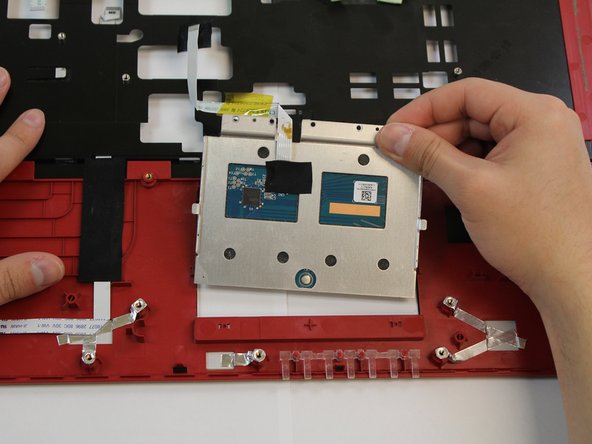

  16. MSI GE70 2PE Apache Pro Touchpad Replacement: crwdns2935265:016crwdnd2935265:01crwdnd2935265:03crwdne2935265:0 MSI GE70 2PE Apache Pro Touchpad Replacement: crwdns2935265:016crwdnd2935265:02crwdnd2935265:03crwdne2935265:0 MSI GE70 2PE Apache Pro Touchpad Replacement: crwdns2935265:016crwdnd2935265:03crwdnd2935265:03crwdne2935265:0
    • Using the plastic opening tool, pry the touchpad off and remove it.
