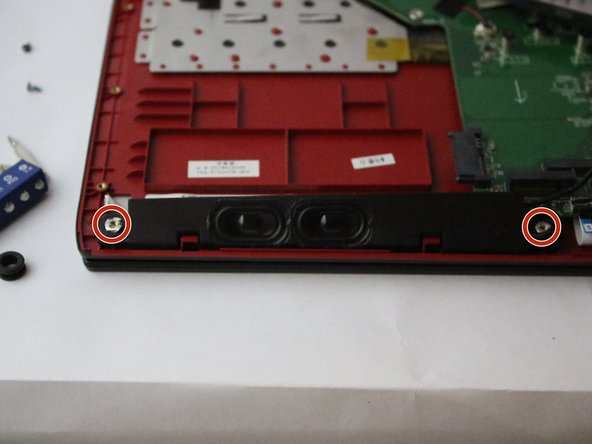

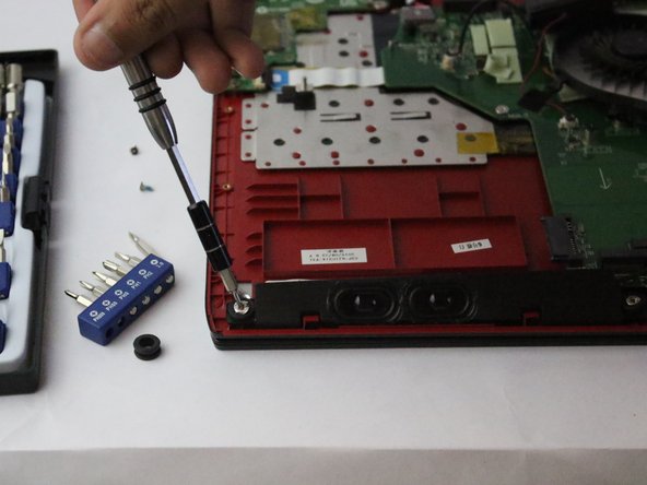

  4. MSI GE62 Apache Pro 004 Speakers Replacement, Speakers: crwdns2935265:04crwdnd2935265:01crwdnd2935265:03crwdne2935265:0 MSI GE62 Apache Pro 004 Speakers Replacement, Speakers: crwdns2935265:04crwdnd2935265:02crwdnd2935265:03crwdne2935265:0 MSI GE62 Apache Pro 004 Speakers Replacement, Speakers: crwdns2935265:04crwdnd2935265:03crwdnd2935265:03crwdne2935265:0
    • Remove the four screws, two on each speaker, with a PH1 screwdriver.

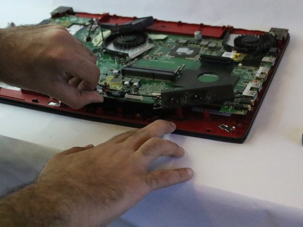

  5. MSI GE62 Apache Pro 004 Speakers Replacement: crwdns2935265:05crwdnd2935265:01crwdnd2935265:02crwdne2935265:0 MSI GE62 Apache Pro 004 Speakers Replacement: crwdns2935265:05crwdnd2935265:02crwdnd2935265:02crwdne2935265:0
    • Gently pull back the speakers until they release from their socket.
    • Keep track of which speaker went where. The connectors for the speakers are unique; you cannot use a speaker that should go on the right side on the left side and vice versa.
