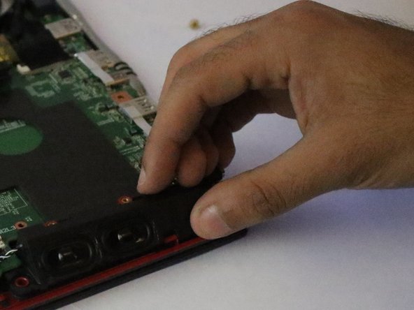

  5. MSI GE62 Apache Pro 004 Motherboard Replacement: crwdns2935265:05crwdnd2935265:01crwdnd2935265:03crwdne2935265:0 MSI GE62 Apache Pro 004 Motherboard Replacement: crwdns2935265:05crwdnd2935265:02crwdnd2935265:03crwdne2935265:0 MSI GE62 Apache Pro 004 Motherboard Replacement: crwdns2935265:05crwdnd2935265:03crwdnd2935265:03crwdne2935265:0
    • Remove the speakers holding the motherboard in place, located on the bottom left and bottom right of the device.
    • Unfasten the 8 screws holding the motherboard in place.
    • Pull out the motherboard.
