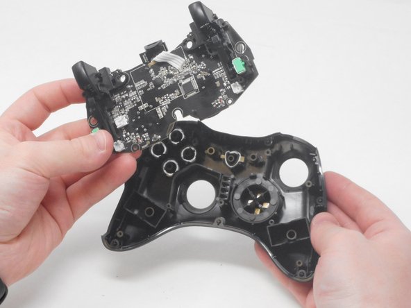

    • Insert an opening pick in the gap between the front and rear case.
    • Slide the pick around the perimeter of the controller while prying until it fully releases.

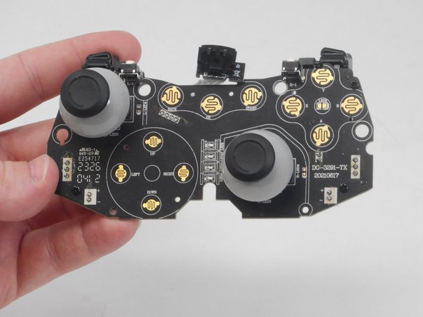

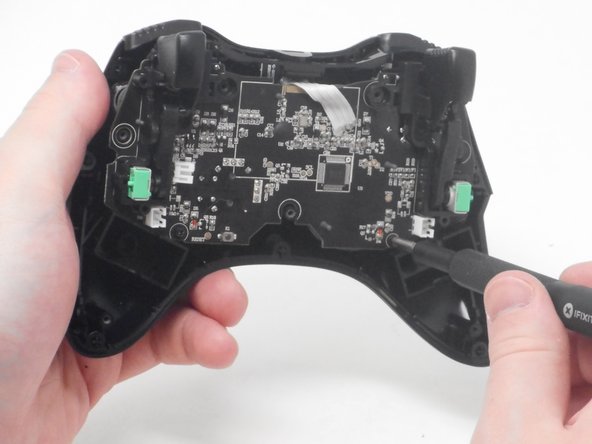

  6. MSI Force GC30 V2 Motherboard Replacement, Motherboard: crwdns2935265:06crwdnd2935265:01crwdnd2935265:03crwdne2935265:0 MSI Force GC30 V2 Motherboard Replacement, Motherboard: crwdns2935265:06crwdnd2935265:02crwdnd2935265:03crwdne2935265:0 MSI Force GC30 V2 Motherboard Replacement, Motherboard: crwdns2935265:06crwdnd2935265:03crwdnd2935265:03crwdne2935265:0
    • Remove the two 7 mm-long screws with a Phillips screwdriver.
    • Carefully lift the motherboard up and out of the chassis.

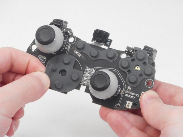

  7. MSI Force GC30 V2 Motherboard Replacement: crwdns2935265:07crwdnd2935265:01crwdnd2935265:03crwdne2935265:0 MSI Force GC30 V2 Motherboard Replacement: crwdns2935265:07crwdnd2935265:02crwdnd2935265:03crwdne2935265:0 MSI Force GC30 V2 Motherboard Replacement: crwdns2935265:07crwdnd2935265:03crwdnd2935265:03crwdne2935265:0
    • Remove the button membranes off of the motherboard.
    • Any other components can be removed as needed.
