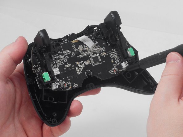

    • Insert an opening pick in the gap between the front and rear case.
    • Slide the pick around the perimeter of the controller while prying until it fully releases.

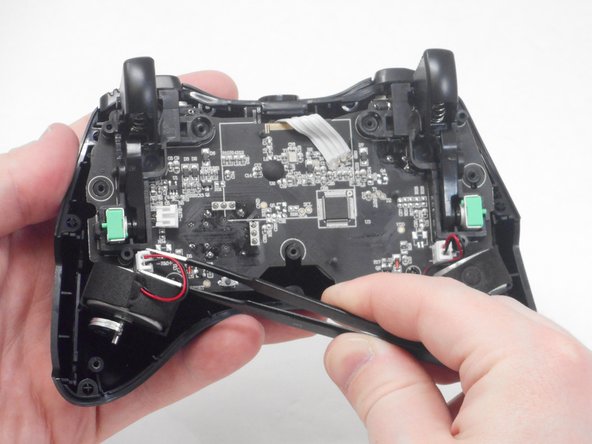

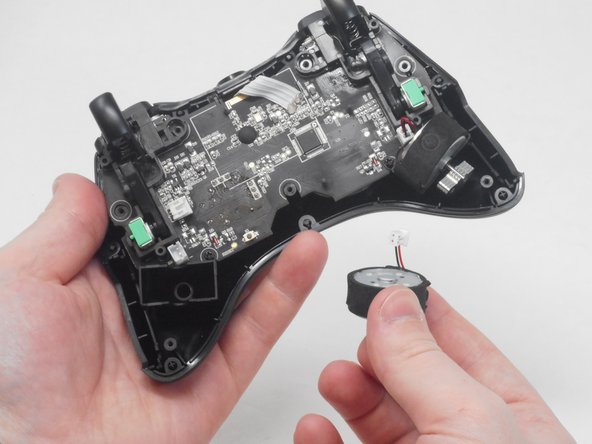

  3. MSI Force GC30 V2 D-Pad Replacement, Vibration Motor: crwdns2935265:03crwdnd2935265:01crwdnd2935265:03crwdne2935265:0 MSI Force GC30 V2 D-Pad Replacement, Vibration Motor: crwdns2935265:03crwdnd2935265:02crwdnd2935265:03crwdne2935265:0 MSI Force GC30 V2 D-Pad Replacement, Vibration Motor: crwdns2935265:03crwdnd2935265:03crwdnd2935265:03crwdne2935265:0
    • Use blunt tweezers to disconnect both of the vibration motor connectors from the motherboard.
    • Grip the white connectors, not the wires.
    • Carefully remove both the right and left vibration motors from their housing.

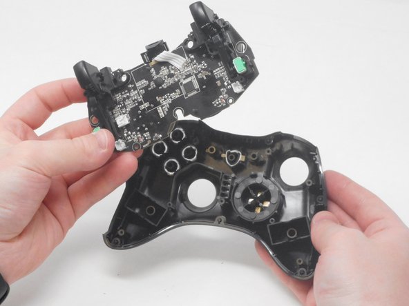

  4. MSI Force GC30 V2 D-Pad Replacement, D-Pad: crwdns2935265:04crwdnd2935265:01crwdnd2935265:03crwdne2935265:0 MSI Force GC30 V2 D-Pad Replacement, D-Pad: crwdns2935265:04crwdnd2935265:02crwdnd2935265:03crwdne2935265:0 MSI Force GC30 V2 D-Pad Replacement, D-Pad: crwdns2935265:04crwdnd2935265:03crwdnd2935265:03crwdne2935265:0
    • Remove the 7.1 mm-long screw with a Phillips screwdriver.
    • Remove the 7 mm-long screw with a Phillips screwdriver.
    • Carefully lift the motherboard out of its housing.

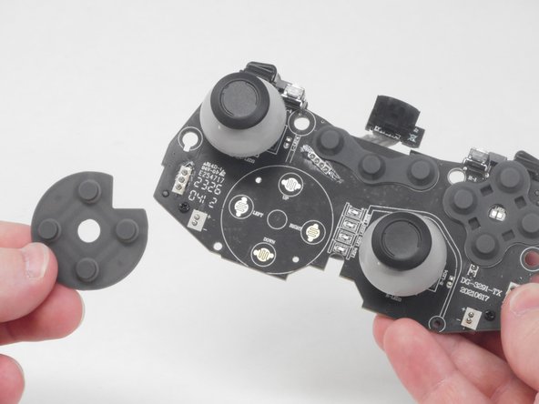

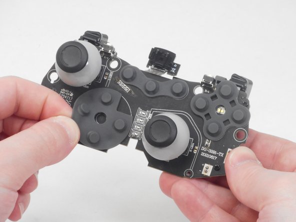

  5. MSI Force GC30 V2 D-Pad Replacement: crwdns2935265:05crwdnd2935265:01crwdnd2935265:03crwdne2935265:0 MSI Force GC30 V2 D-Pad Replacement: crwdns2935265:05crwdnd2935265:02crwdnd2935265:03crwdne2935265:0 MSI Force GC30 V2 D-Pad Replacement: crwdns2935265:05crwdnd2935265:03crwdnd2935265:03crwdne2935265:0
    • Remove the rubber button membrane from the motherboard.

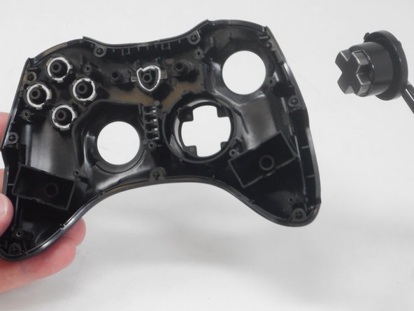

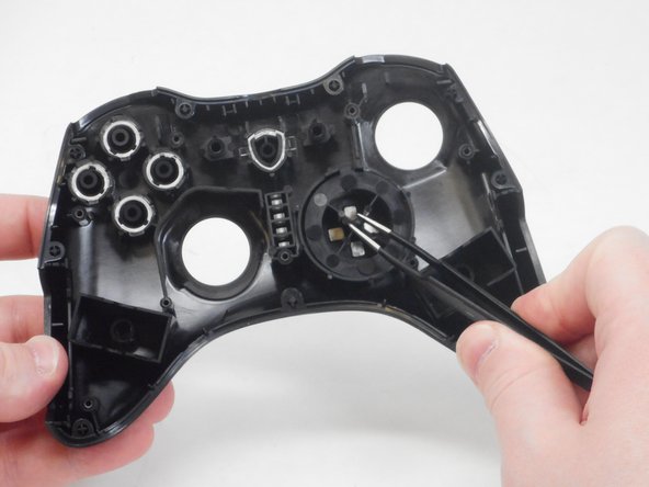

  6. MSI Force GC30 V2 D-Pad Replacement: crwdns2935265:06crwdnd2935265:01crwdnd2935265:03crwdne2935265:0 MSI Force GC30 V2 D-Pad Replacement: crwdns2935265:06crwdnd2935265:02crwdnd2935265:03crwdne2935265:0 MSI Force GC30 V2 D-Pad Replacement: crwdns2935265:06crwdnd2935265:03crwdnd2935265:03crwdne2935265:0
    • Remove the D-pad from the front case.

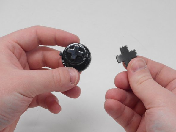

  7. MSI Force GC30 V2 D-Pad Replacement: crwdns2935265:07crwdnd2935265:01crwdnd2935265:02crwdne2935265:0 MSI Force GC30 V2 D-Pad Replacement: crwdns2935265:07crwdnd2935265:02crwdnd2935265:02crwdne2935265:0
    • Optional: Remove the D-Pad end cap from D-Pad button.
    • The included alternate D-Pad end cap can be reattached after reassembling the device.
