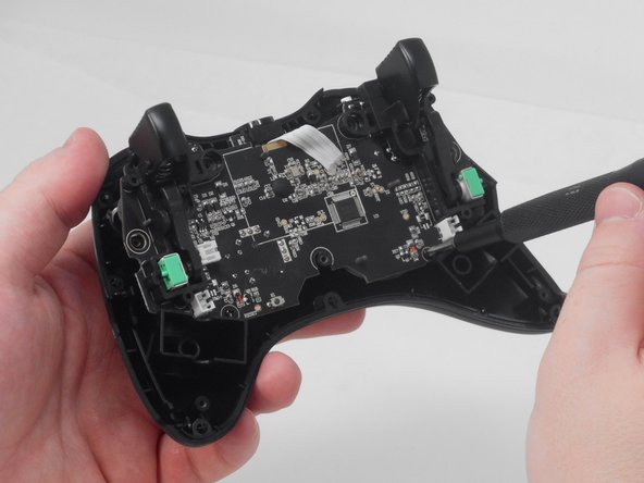

  3. MSI Force GC30 V2 ABXY Buttons Replacement, Battery: crwdns2935265:03crwdnd2935265:01crwdnd2935265:01crwdne2935265:0
    • Use tweezers to grip the white battery connector.
    • Pull the battery connector directly out of its port.
    • Do not pull on the wires.

  5. MSI Force GC30 V2 ABXY Buttons Replacement, Vibration Motor: crwdns2935265:05crwdnd2935265:01crwdnd2935265:03crwdne2935265:0 MSI Force GC30 V2 ABXY Buttons Replacement, Vibration Motor: crwdns2935265:05crwdnd2935265:02crwdnd2935265:03crwdne2935265:0 MSI Force GC30 V2 ABXY Buttons Replacement, Vibration Motor: crwdns2935265:05crwdnd2935265:03crwdnd2935265:03crwdne2935265:0
    • Use blunt tweezers to disconnect both of the vibration motor connectors from the motherboard.
    • Grip the white connectors, not the wires.
    • Carefully remove both the right and left vibration motors from their housing.

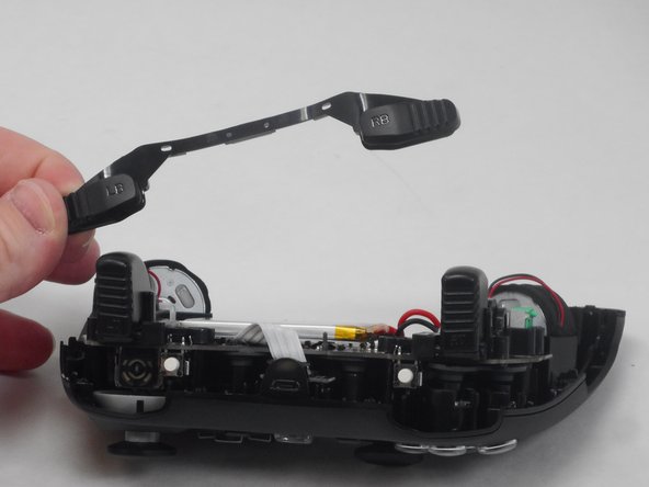

    • Remove the left/right bumper assembly.

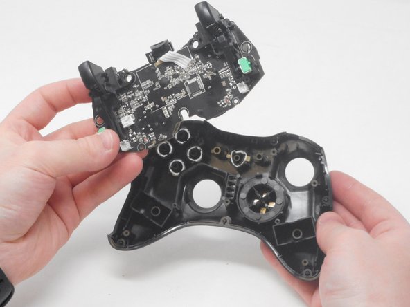

    • Carefully lift the motherboard out of its casing and remove it.

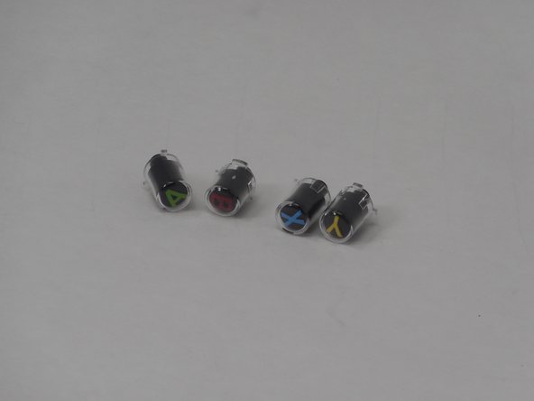

    • Remove the ABXY button either by pulling them out or turning the controller the other side and letting the buttons fall out.

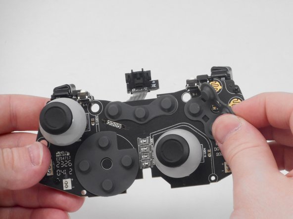

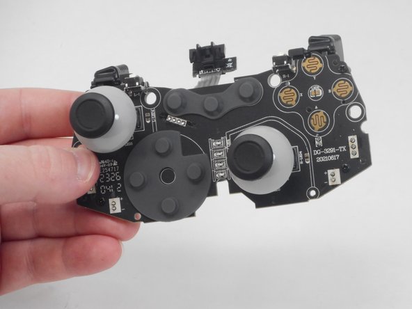

    • Remove the ABXY button membrane by carefully lifting it off the motherboard.
