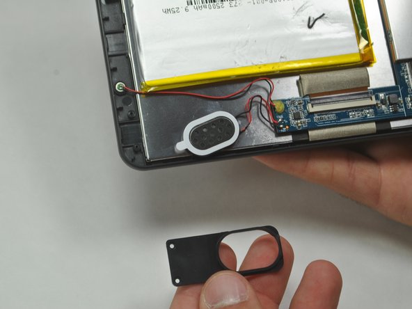

    • Separate the back of the device from the face by inserting the flat end of the nylon spudger into the corner of the device to safely pry it open.
  2. MJS T2702 Speaker Replacement: crwdns2935265:02crwdnd2935265:01crwdnd2935265:02crwdne2935265:0 MJS T2702 Speaker Replacement: crwdns2935265:02crwdnd2935265:02crwdnd2935265:02crwdne2935265:0
    • Remove the 4.1 mm screws connecting the speaker to the device by using the Phillips Head J #000.
  3. MJS T2702 Speaker Replacement: crwdns2935265:03crwdnd2935265:01crwdnd2935265:02crwdne2935265:0 MJS T2702 Speaker Replacement: crwdns2935265:03crwdnd2935265:02crwdnd2935265:02crwdne2935265:0
    • Remove the plastic cover from the speaker by pulling it off gently with your hands.
  4. MJS T2702 Speaker Replacement: crwdns2935265:04crwdnd2935265:01crwdnd2935265:01crwdne2935265:0
