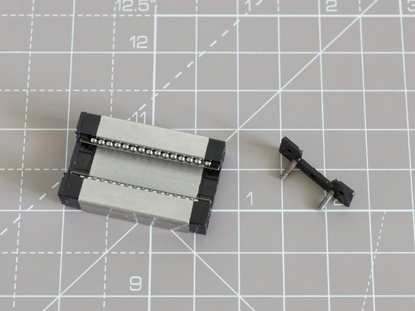

    3. MGN Linear Guide, Removing Stock Grease: crwdns2935265:04crwdnd2935265:01crwdnd2935265:03crwdne2935265:0 MGN Linear Guide, Removing Stock Grease: crwdns2935265:04crwdnd2935265:02crwdnd2935265:03crwdne2935265:0 MGN Linear Guide, Removing Stock Grease: crwdns2935265:04crwdnd2935265:03crwdnd2935265:03crwdne2935265:0
      • Cheap Chinese linear rails are often coated with a thick grease that prevents rust and corrosion. However this prevents the carriage from traveling smoothly.
      • Do not use any magnetic tools on the ball bearings. This will magnetize the balls causing more friction.
      • Remove the 2 screws and the rubber seal on both sides of the carriage block.
      • Using a small flat head screwdriver to nudge the retaining wire out if it's groove.
      • The retaining wire needs to bent slightly in order to remove it. Take care to not bend it too much.
      • At this point the ball bearings are free to fall out so when you remove the retaining wire have a container to put the bearings in ready.
      • There should be 66 ball bearings.
    4. MGN Linear Guide, Removing Stock Grease: crwdns2935265:05crwdnd2935265:01crwdnd2935265:01crwdne2935265:0
      • With the ball bearings in a container pour in a little degreaser.
      • Kerosene, Mineral Spirits, or WD-40 Degreasers(not regular WD-40) are all great products you can use. Do not use it on non metal parts. Petroleum-based degreaser can eat away plastic and rubber components.
      • Cleaning the oil off is simple. Put a lid on the container and shake it. When finished remove the balls from the container and set them on a microfiber cloth to try.
      • Degreasers can be harmful to skin. I recommend wearing rubber/latex gloves.

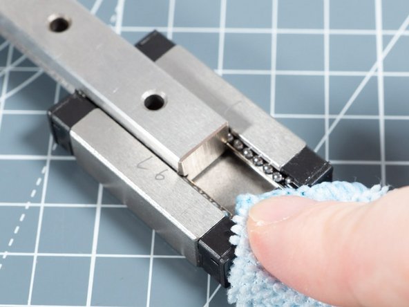

      • Wipe the inside of the metal block and end caps with a microfiber cloth. I use a pipe cleaner to clean the channel.

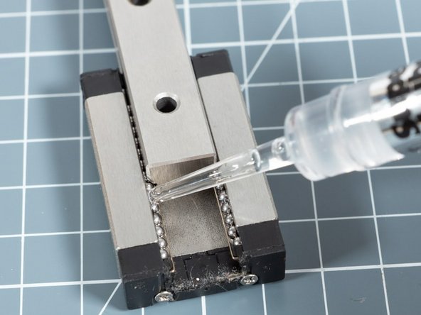

    6. MGN Linear Guide, Applying Grease: crwdns2935265:07crwdnd2935265:01crwdnd2935265:03crwdne2935265:0 MGN Linear Guide, Applying Grease: crwdns2935265:07crwdnd2935265:02crwdnd2935265:03crwdne2935265:0 MGN Linear Guide, Applying Grease: crwdns2935265:07crwdnd2935265:03crwdnd2935265:03crwdne2935265:0
      • High viscos(thick) lubrication will prevent the ball bearings from circulating freely. If it's too thin you'll need to re-apply often.
      • I recommend Super Lube 51010. It's an excellent PTFE-based lubricant. 51014, 51004, 51008, 51025 can be used as a substitute. They're the same product but in a different packaging.
      • Shake the bottle well. Apply 1-2 drops into the ball bearings on both sides of the carriage block.
      • If you notice dust and hair collected onto the rubber seal give it a quick wipe with a microfiber cloth. Don't forget to do the opposite side of the block.
