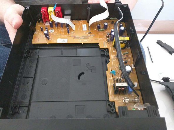

  5. MAGNAVOX MDV2300 Power Cord Replacement: crwdns2935265:05crwdnd2935265:01crwdnd2935265:02crwdne2935265:0 MAGNAVOX MDV2300 Power Cord Replacement: crwdns2935265:05crwdnd2935265:02crwdnd2935265:02crwdne2935265:0
    • Remove disc drive by unscrewing the 2 screws that hold the drive in place.
  6. MAGNAVOX MDV2300 Power Cord Replacement: crwdns2935265:06crwdnd2935265:01crwdnd2935265:01crwdne2935265:0
    • Identify the power cord.
    • The cord must either be too short or torn to warrant replacement.
  7. MAGNAVOX MDV2300 Power Cord Replacement: crwdns2935265:07crwdnd2935265:01crwdnd2935265:01crwdne2935265:0
    • Cut the old wire out from the chip.
    • Attach the new wire into the housing.
    • Line up new wire with the appropriate holes and solder to board.
    • The white wire will be your neutral and the black wire will be your negative. View link of how to solder in order to replace the power cord. http://www.instructables.com/id/How-to-s...
After soldering, let cool and then reassemble your device, follow these instructions in reverse order.
