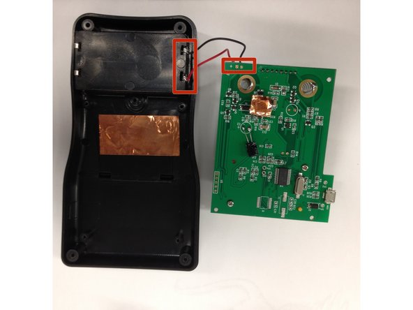

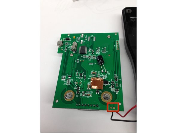

  3. M6013 Capacitor Meter Teardown, Remove Circuit Board: crwdns2935265:03crwdnd2935265:01crwdnd2935265:03crwdne2935265:0 M6013 Capacitor Meter Teardown, Remove Circuit Board: crwdns2935265:03crwdnd2935265:02crwdnd2935265:03crwdne2935265:0 M6013 Capacitor Meter Teardown, Remove Circuit Board: crwdns2935265:03crwdnd2935265:03crwdnd2935265:03crwdne2935265:0
    • Remove circled screws
    • Be careful when removing the circuit board, the battery cable is still connected.
    • Unsolder the square locations either on the circuit board or the case to fully remove the circuit board

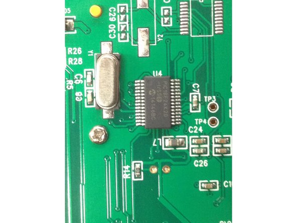

  4. M6013 Capacitor Meter Teardown, Microprocessor: crwdns2935265:04crwdnd2935265:01crwdnd2935265:02crwdne2935265:0 M6013 Capacitor Meter Teardown, Microprocessor: crwdns2935265:04crwdnd2935265:02crwdnd2935265:02crwdne2935265:0
    • Location of microprocessor

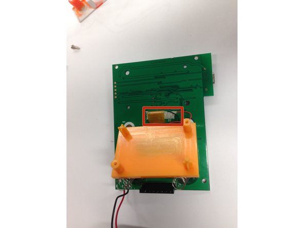

  5. M6013 Capacitor Meter Teardown, Remove Display: crwdns2935265:05crwdnd2935265:01crwdnd2935265:02crwdne2935265:0 M6013 Capacitor Meter Teardown, Remove Display: crwdns2935265:05crwdnd2935265:02crwdnd2935265:02crwdne2935265:0
    • Remove the cable connector
    • Remove Display

Hello everyone, can someone help me identify the regulator that is in the printed circuit of this capacimeter identified with "U1" and the diode "D1" I appreciate any information.
