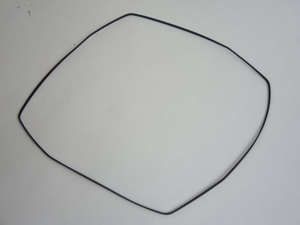

  4. M3D Micro Z Axis Belt Replacement, Z Axis Belt: crwdns2935265:04crwdnd2935265:01crwdnd2935265:03crwdne2935265:0 M3D Micro Z Axis Belt Replacement, Z Axis Belt: crwdns2935265:04crwdnd2935265:02crwdnd2935265:03crwdne2935265:0 M3D Micro Z Axis Belt Replacement, Z Axis Belt: crwdns2935265:04crwdnd2935265:03crwdnd2935265:03crwdne2935265:0
    • Remove the z axis belt from the device by simply lifting each corner of the belt off the corner gears and slide up over the z axis bars.
