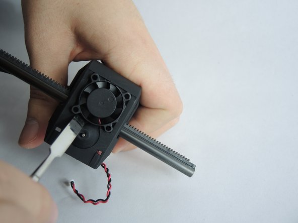

    4. M3D Micro Nozzle Replacement: crwdns2935265:04crwdnd2935265:01crwdnd2935265:03crwdne2935265:0 M3D Micro Nozzle Replacement: crwdns2935265:04crwdnd2935265:02crwdnd2935265:03crwdne2935265:0 M3D Micro Nozzle Replacement: crwdns2935265:04crwdnd2935265:03crwdnd2935265:03crwdne2935265:0
      • The fan is held loosely in place at the base of the printer head. Use a metal spudger to gently pry it out of the printer head.

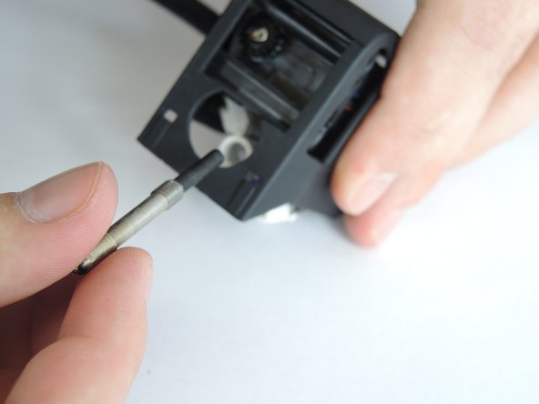

    1. M3D Micro Nozzle Replacement, Nozzle: crwdns2935265:06crwdnd2935265:01crwdnd2935265:02crwdne2935265:0 M3D Micro Nozzle Replacement, Nozzle: crwdns2935265:06crwdnd2935265:02crwdnd2935265:02crwdne2935265:0
      • To remove the nozzle insulation, grip the insulation and pull it up off of the nozzle.
    2. M3D Micro Nozzle Replacement: crwdns2935265:07crwdnd2935265:01crwdnd2935265:02crwdne2935265:0 M3D Micro Nozzle Replacement: crwdns2935265:07crwdnd2935265:02crwdnd2935265:02crwdne2935265:0
      • To remove the nozzle, use a 5 mm nut driver to unscrew it.
