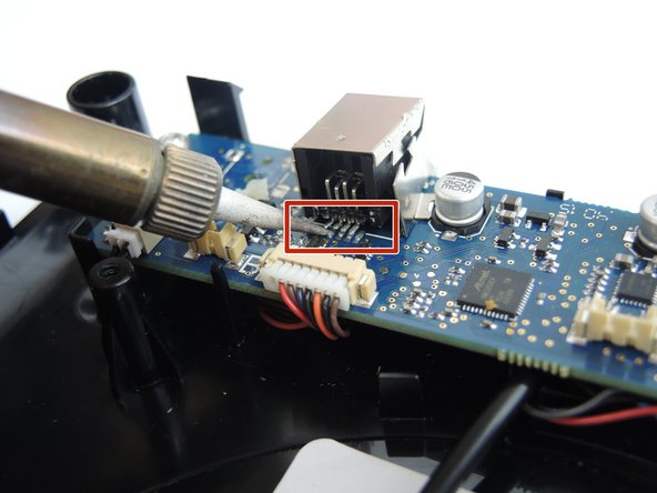

      • The ports are primarily soldered on to the board but are additionally secured using glue. Use the sharp metal spudger tool to gently pry apart the glue surrounding the ports.
    5. M3D Micro Data and Power Port Replacement: crwdns2935265:05crwdnd2935265:01crwdnd2935265:02crwdne2935265:0 M3D Micro Data and Power Port Replacement: crwdns2935265:05crwdnd2935265:02crwdnd2935265:02crwdne2935265:0
      • To remove the charging port grasp the port with a pair of pliers and use a soldering iron to desolder the joints at the red marks while carefully pulling away with the pliers.

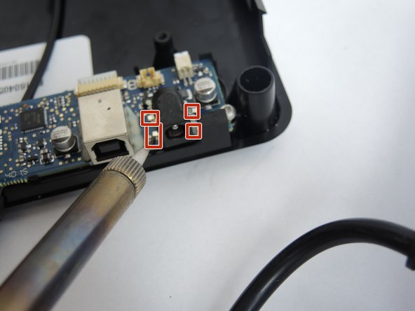

      • To replace the power port, match the four contact points on the board to the new port and carefully solder the components together.
    7. M3D Micro Data and Power Port Replacement: crwdns2935265:07crwdnd2935265:01crwdnd2935265:02crwdne2935265:0 M3D Micro Data and Power Port Replacement: crwdns2935265:07crwdnd2935265:02crwdnd2935265:02crwdne2935265:0
      • To replace the USB data port, follow the same procedure as Step 5. The contact pins for the data port are on the back. The red marker indicates the four contact pins that must be matched up and carefully soldered on.
