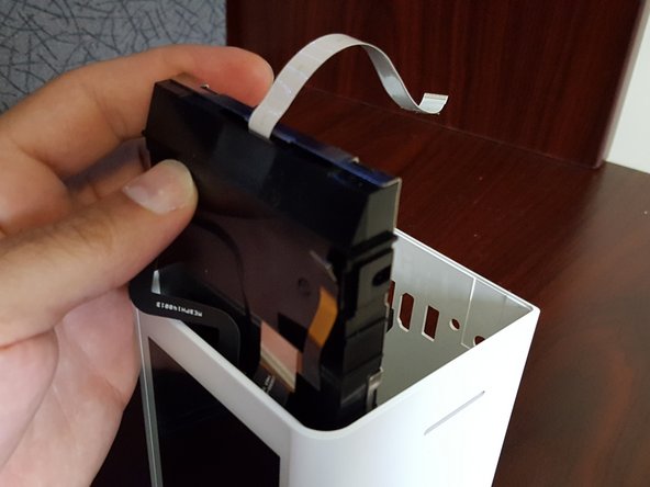

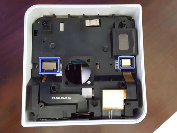

  5. Lyve Home Teardown, Remove main board enclosure: crwdns2935265:05crwdnd2935265:01crwdnd2935265:02crwdne2935265:0 Lyve Home Teardown, Remove main board enclosure: crwdns2935265:05crwdnd2935265:02crwdnd2935265:02crwdne2935265:0
    • Remove the 6 hex screws attaching the main board enclosure to case
    • Remove connection ribbons that connect to the front LCD screen
  6. Lyve Home Teardown, Remove Mainboard enclosure: crwdns2935265:06crwdnd2935265:01crwdnd2935265:03crwdne2935265:0 Lyve Home Teardown, Remove Mainboard enclosure: crwdns2935265:06crwdnd2935265:02crwdnd2935265:03crwdne2935265:0 Lyve Home Teardown, Remove Mainboard enclosure: crwdns2935265:06crwdnd2935265:03crwdnd2935265:03crwdne2935265:0

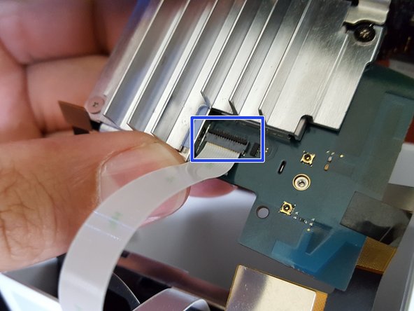

    • Remove the mainboard enclousre from the case by placing your finger in the middle hole and removing it carefully from the case

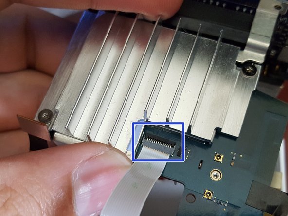

    • Remove the tape on top of the ribbon connector. this connects to the harddrive
    • Unlock the connector by flipping the lock back to front. this flap is located closets to the heatsink
    • pull the ribbon cable away from the mailboard

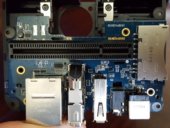

    • Remove main board from the enclosure board.

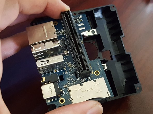

  9. Lyve Home Teardown, Remove Main board from Expansion Board: crwdns2935265:09crwdnd2935265:01crwdnd2935265:02crwdne2935265:0 Lyve Home Teardown, Remove Main board from Expansion Board: crwdns2935265:09crwdnd2935265:02crwdnd2935265:02crwdne2935265:0
    • Remove the main board carefully away from the expansion board.

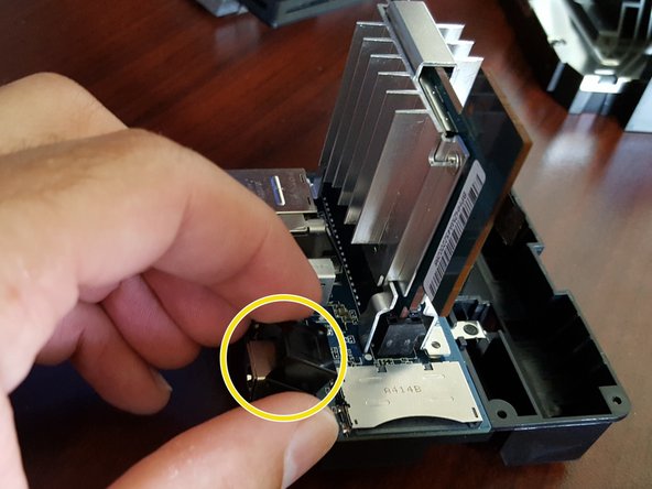

  10. Lyve Home Teardown, Remove expansion board from enclosure: crwdns2935265:010crwdnd2935265:01crwdnd2935265:02crwdne2935265:0 Lyve Home Teardown, Remove expansion board from enclosure: crwdns2935265:010crwdnd2935265:02crwdnd2935265:02crwdne2935265:0
    • Carefully remove the expansion board away from the enclosure but un clipping it.
    • Its recommended to start from the side with the SD card slot.

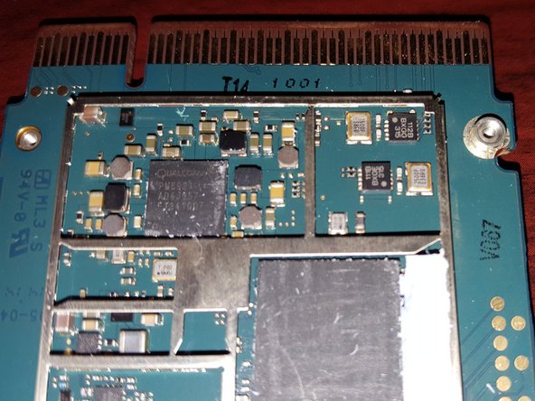

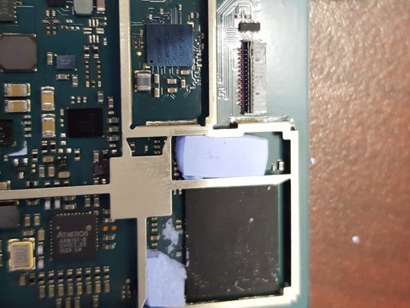

  11. Lyve Home Teardown, EXTRA - Board Pictures: crwdns2935265:011crwdnd2935265:01crwdnd2935265:02crwdne2935265:0 Lyve Home Teardown, EXTRA - Board Pictures: crwdns2935265:011crwdnd2935265:02crwdnd2935265:02crwdne2935265:0
    • These are pictures of the main board components under the shielding
    • Qualcomm | PM8921 | AD4J957

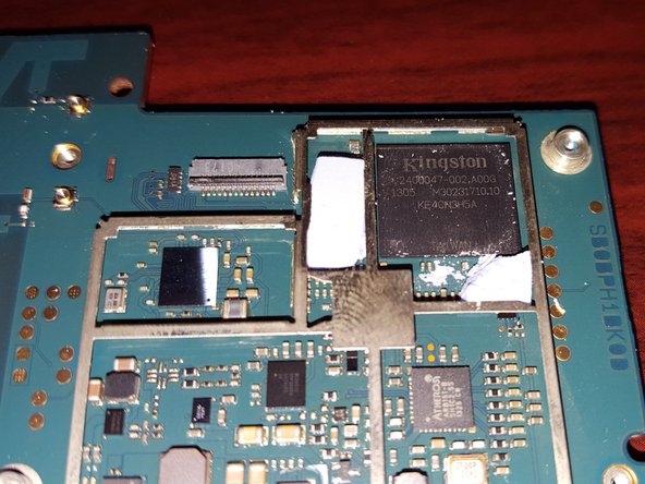

  12. Lyve Home Teardown, EXTRA - Board Pictures 2: crwdns2935265:012crwdnd2935265:01crwdnd2935265:03crwdne2935265:0 Lyve Home Teardown, EXTRA - Board Pictures 2: crwdns2935265:012crwdnd2935265:02crwdnd2935265:03crwdne2935265:0 Lyve Home Teardown, EXTRA - Board Pictures 2: crwdns2935265:012crwdnd2935265:03crwdnd2935265:03crwdne2935265:0
    • Kingston eMMC 8GB | 240047-002,A00G | 1305 M30231710.10 | KE4CN3H5A
    • Gigabit Ethernet | Atheros | AR8151
    • Broadcom | BCM4339XXUBG
