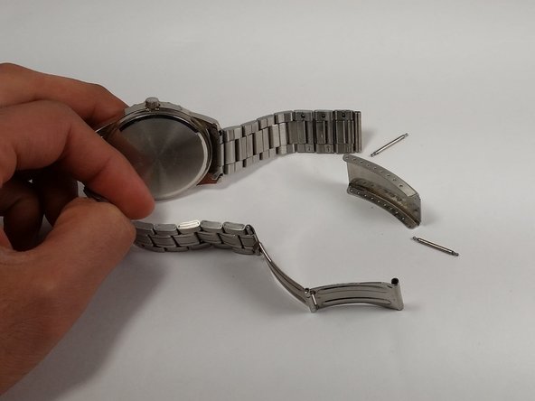

    • Measure the watch band to decide how many links to remove.
    • It is better to remove an even number of links to keep the clasp centered and symmetrical.
  2. Luxury Fashion Quality Military Quartz Watch Link Replacement: crwdns2935265:02crwdnd2935265:01crwdnd2935265:02crwdne2935265:0 Luxury Fashion Quality Military Quartz Watch Link Replacement: crwdns2935265:02crwdnd2935265:02crwdnd2935265:02crwdne2935265:0
    • Separate the clasp by pushing in the spring pin.
  3. Luxury Fashion Quality Military Quartz Watch Link Replacement: crwdns2935265:03crwdnd2935265:01crwdnd2935265:02crwdne2935265:0 Luxury Fashion Quality Military Quartz Watch Link Replacement: crwdns2935265:03crwdnd2935265:02crwdnd2935265:02crwdne2935265:0
    • Remove the clasp from the lug by pushing in on the spring pin.

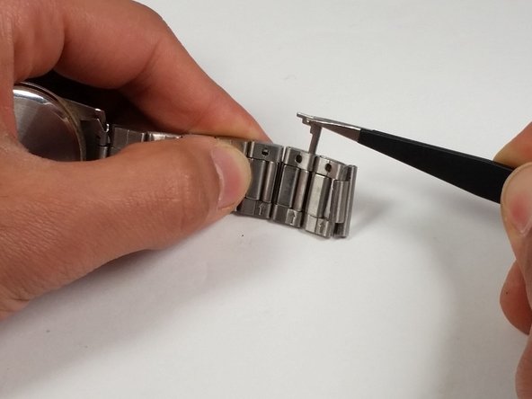

  4. Luxury Fashion Quality Military Quartz Watch Link Replacement: crwdns2935265:04crwdnd2935265:01crwdnd2935265:02crwdne2935265:0 Luxury Fashion Quality Military Quartz Watch Link Replacement: crwdns2935265:04crwdnd2935265:02crwdnd2935265:02crwdne2935265:0
    • To remove the first link and lug, push in on the link pin to raise it up.
    • Grasp the link pin and pull it out from the link.

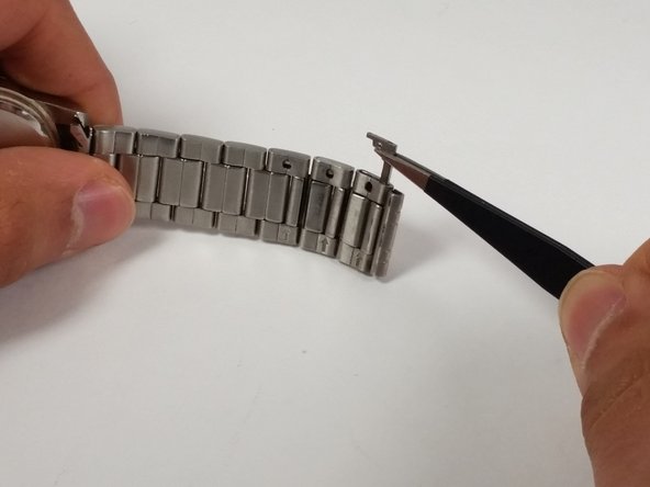

  5. Luxury Fashion Quality Military Quartz Watch Link Replacement: crwdns2935265:05crwdnd2935265:01crwdnd2935265:02crwdne2935265:0 Luxury Fashion Quality Military Quartz Watch Link Replacement: crwdns2935265:05crwdnd2935265:02crwdnd2935265:02crwdne2935265:0
    • Push in on the second link pin.
    • Grasp the link pin and pull it up and out.
  6. Luxury Fashion Quality Military Quartz Watch Link Replacement: crwdns2935265:06crwdnd2935265:01crwdnd2935265:01crwdne2935265:0
    • Pull the link apart to remove it from the band.
