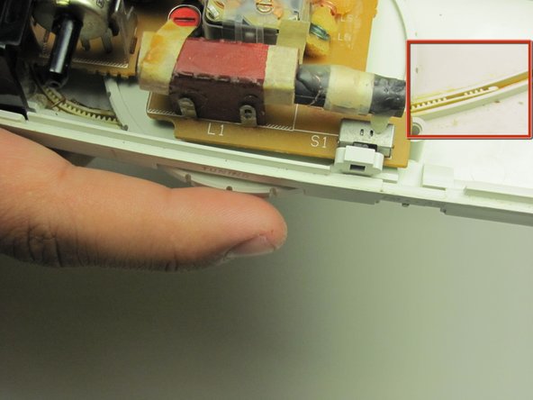

  7. Lubricate General Electric Telephone 2-9710A Tuning Slider, Lubricate General Electric Telephone 2-9710A Tuning Slider: crwdns2935265:07crwdnd2935265:01crwdnd2935265:02crwdne2935265:0 Lubricate General Electric Telephone 2-9710A Tuning Slider, Lubricate General Electric Telephone 2-9710A Tuning Slider: crwdns2935265:07crwdnd2935265:02crwdnd2935265:02crwdne2935265:0
    • Turn the tuning slider counterclockwise until the slider stops.
    • Apply lubricant to the slider rail.
    • Turn the tuning slider back and forth to distribute the lubricant.
    • Make sure the lubricant does not touch the circuit board. This can damage the circuit board.
