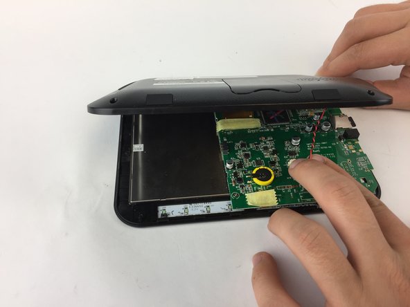

  3. Lorex LW2742 Speaker Replacement: crwdns2935265:03crwdnd2935265:01crwdnd2935265:02crwdne2935265:0 Lorex LW2742 Speaker Replacement: crwdns2935265:03crwdnd2935265:02crwdnd2935265:02crwdne2935265:0
    • Using a plastic opening tool, gently separate the back panel from the front panel, working the tool around the panel to disconnect it.
    • Carefully remove the back panel
    • The speaker wire is connected to the motherboard so DO NOT rip back panel away from the monitor.

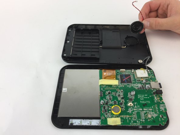

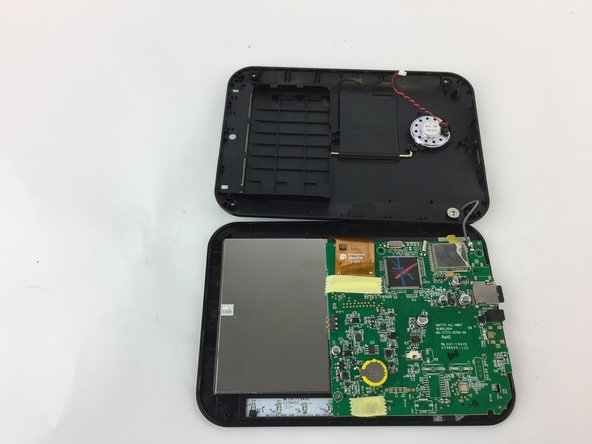

  4. Lorex LW2742 Speaker Replacement, Speaker: crwdns2935265:04crwdnd2935265:01crwdnd2935265:03crwdne2935265:0 Lorex LW2742 Speaker Replacement, Speaker: crwdns2935265:04crwdnd2935265:02crwdnd2935265:03crwdne2935265:0 Lorex LW2742 Speaker Replacement, Speaker: crwdns2935265:04crwdnd2935265:03crwdnd2935265:03crwdne2935265:0
    • Locate the motherboard and carefully pull the red and black speaker wires out of their harness.
  5. Lorex LW2742 Speaker Replacement: crwdns2935265:05crwdnd2935265:01crwdnd2935265:02crwdne2935265:0 Lorex LW2742 Speaker Replacement: crwdns2935265:05crwdnd2935265:02crwdnd2935265:02crwdne2935265:0
    • Using a metal spudger, pry the melted black plastic away from the speaker.
    • Carefully pull the speaker out of its housing by the wires.
