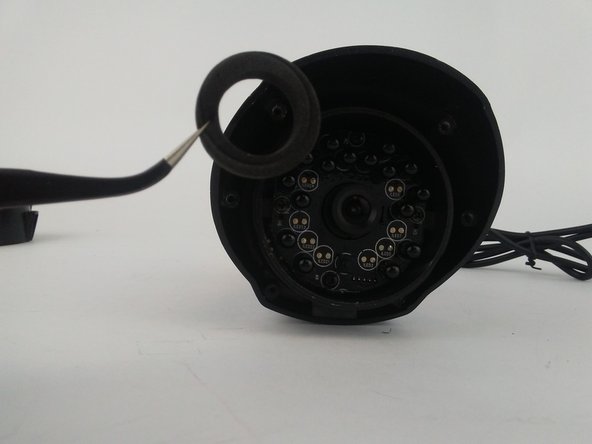

      • Remove the foam ring around the lens with tweezers.
      • Be aware, the electronic components of the LED board may be compromised if you use your fingers instead of tweezers for this step.

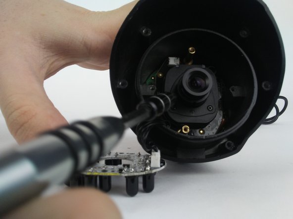

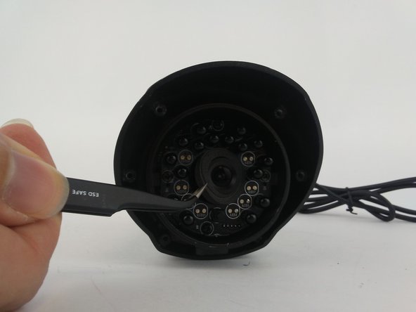

    5. Lorex LW2742 Lens Replacement: crwdns2935265:05crwdnd2935265:01crwdnd2935265:01crwdne2935265:0
      • Remove the LED board with tweezers.
      • It is unnecessary to unplug the LED board from internal components for lens replacement.
