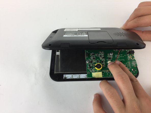

    3. Lorex LW2742 LCD Display Replacement: crwdns2935265:03crwdnd2935265:01crwdnd2935265:02crwdne2935265:0 Lorex LW2742 LCD Display Replacement: crwdns2935265:03crwdnd2935265:02crwdnd2935265:02crwdne2935265:0
      • Using a plastic opening tool, gently separate the back panel from the front panel, working the tool around the panel to disconnect it.
      • Carefully remove the back panel
      • The speaker wire is connected to the motherboard so DO NOT rip back panel away from the monitor.

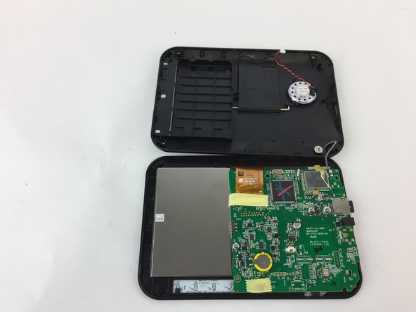

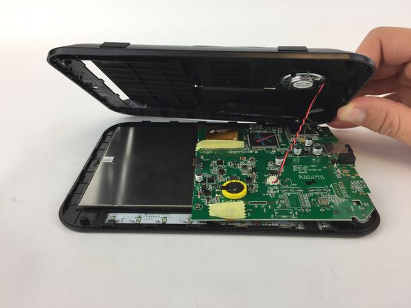

    1. Lorex LW2742 LCD Display Replacement, LCD Display: crwdns2935265:04crwdnd2935265:01crwdnd2935265:03crwdne2935265:0 Lorex LW2742 LCD Display Replacement, LCD Display: crwdns2935265:04crwdnd2935265:02crwdnd2935265:03crwdne2935265:0 Lorex LW2742 LCD Display Replacement, LCD Display: crwdns2935265:04crwdnd2935265:03crwdnd2935265:03crwdne2935265:0
      • Locate the motherboard and carefully pull the red and black speaker wires out of their harness.
    2. Lorex LW2742 LCD Display Replacement: crwdns2935265:05crwdnd2935265:01crwdnd2935265:01crwdne2935265:0
      • Remove the two 5mm Phillips #1 screws that are holding the motherboard in place.

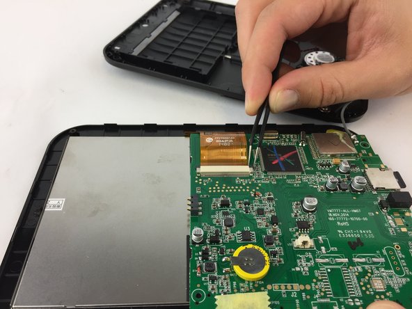

    3. Lorex LW2742 LCD Display Replacement: crwdns2935265:06crwdnd2935265:01crwdnd2935265:02crwdne2935265:0 Lorex LW2742 LCD Display Replacement: crwdns2935265:06crwdnd2935265:02crwdnd2935265:02crwdne2935265:0
      • Peel away the yellow tape that is covering the large harness.
      • Use needle-nosed tweezers to pull out the black tabs that are holding the film in the harness and gently pull the film out of the harness.

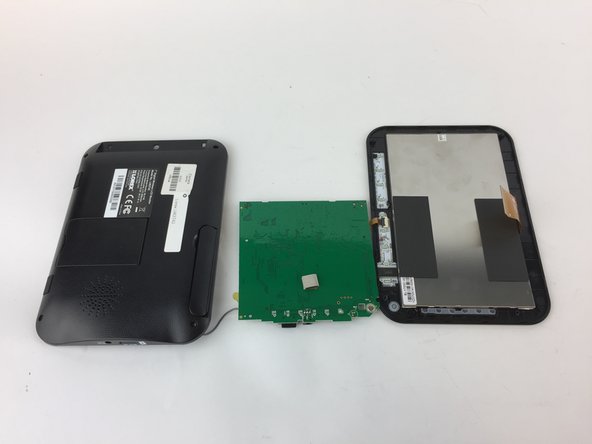

    4. Lorex LW2742 LCD Display Replacement: crwdns2935265:07crwdnd2935265:01crwdnd2935265:02crwdne2935265:0 Lorex LW2742 LCD Display Replacement: crwdns2935265:07crwdnd2935265:02crwdnd2935265:02crwdne2935265:0

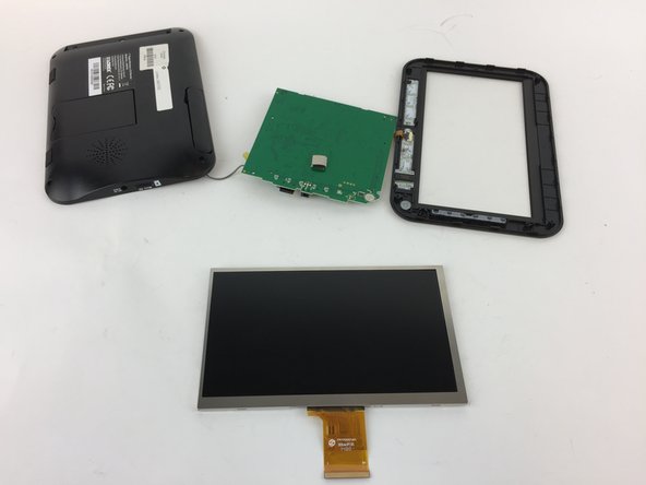

      • Flip the back panel and motherboard over to reveal the back of the LCD monitor
    5. Lorex LW2742 LCD Display Replacement: crwdns2935265:08crwdnd2935265:01crwdnd2935265:02crwdne2935265:0 Lorex LW2742 LCD Display Replacement: crwdns2935265:08crwdnd2935265:02crwdnd2935265:02crwdne2935265:0
      • The LCD monitor will easily come out of the front casing of the monitor.
