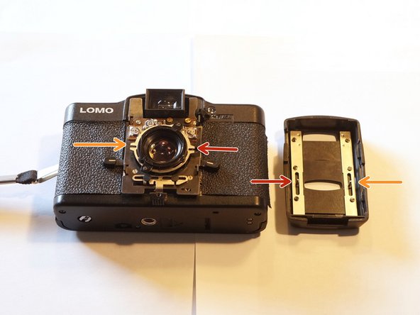

  2. Lomo LC-A: fixing the exposure / picture counter, Removing the front panel: crwdns2935265:02crwdnd2935265:01crwdnd2935265:03crwdne2935265:0 Lomo LC-A: fixing the exposure / picture counter, Removing the front panel: crwdns2935265:02crwdnd2935265:02crwdnd2935265:03crwdne2935265:0 Lomo LC-A: fixing the exposure / picture counter, Removing the front panel: crwdns2935265:02crwdnd2935265:03crwdnd2935265:03crwdne2935265:0
    • Remove the 4 screws (Phillips, 2.7mm) on the left and right side of the front cover. Lift the cover straight up. Sometimes it fits very tight. Just apply careful lifting force.
    • When assembling, pay attention to the alignment of the pins and slots. It works best if everything is aligned “centrally” on both the camera and cover sides.

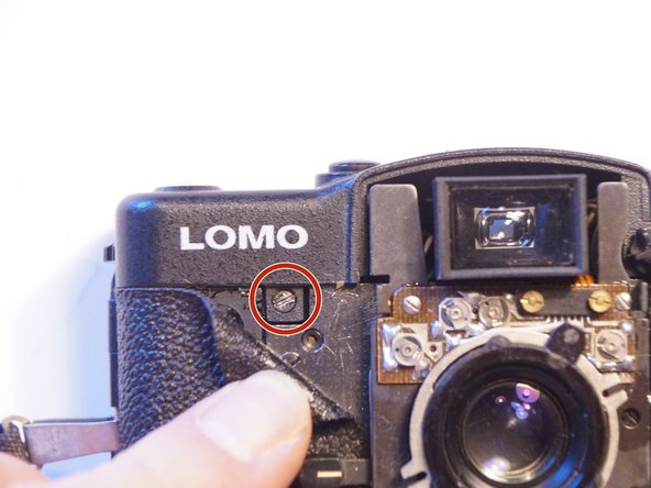

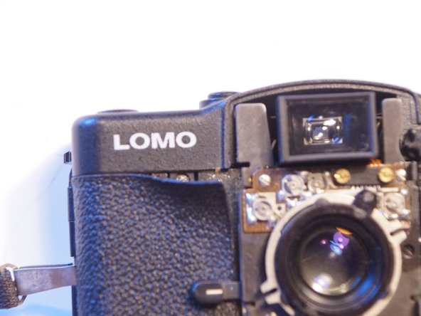

  3. Lomo LC-A: fixing the exposure / picture counter, Remove the leather cover: crwdns2935265:03crwdnd2935265:01crwdnd2935265:03crwdne2935265:0 Lomo LC-A: fixing the exposure / picture counter, Remove the leather cover: crwdns2935265:03crwdnd2935265:02crwdnd2935265:03crwdne2935265:0 Lomo LC-A: fixing the exposure / picture counter, Remove the leather cover: crwdns2935265:03crwdnd2935265:03crwdnd2935265:03crwdne2935265:0
    • Using a scalpel or a sharp knife to remove the glue and loosen the leather in the grip area. Underneath the leather are hidden screws.
    • The one shown in picture #3 needs to be removed in the next step.

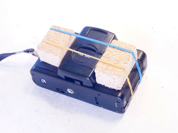

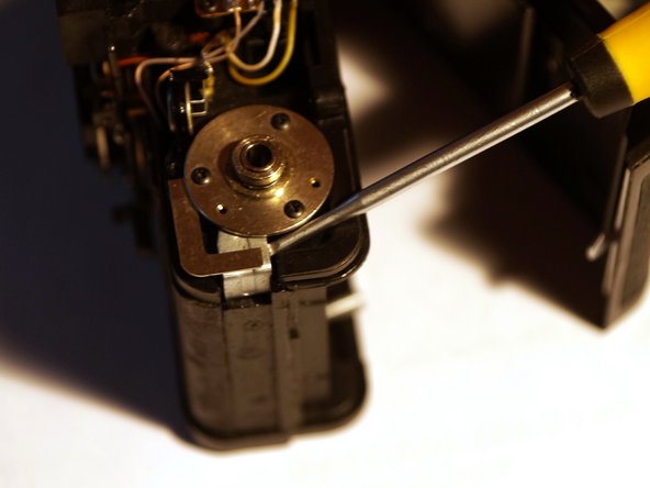

  5. Lomo LC-A: fixing the exposure / picture counter, Remove the rewind crank.: crwdns2935265:05crwdnd2935265:01crwdnd2935265:03crwdne2935265:0 Lomo LC-A: fixing the exposure / picture counter, Remove the rewind crank.: crwdns2935265:05crwdnd2935265:02crwdnd2935265:03crwdne2935265:0 Lomo LC-A: fixing the exposure / picture counter, Remove the rewind crank.: crwdns2935265:05crwdnd2935265:03crwdnd2935265:03crwdne2935265:0
    • If you block the shaft with a screwdriver as shown, you can completely remove the crank by turning it counterclockwise.
    • To prevent the back cover from snapping shut and becoming impossible to reopen, I recommend reattaching the crank afterward.
    • Alternatively, you can open the back cover by using a screwdriver to pry up the metal bracket as shown.

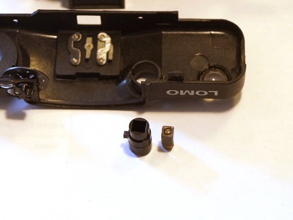

  6. Lomo LC-A: fixing the exposure / picture counter, Remove the top cover.: crwdns2935265:06crwdnd2935265:01crwdnd2935265:03crwdne2935265:0 Lomo LC-A: fixing the exposure / picture counter, Remove the top cover.: crwdns2935265:06crwdnd2935265:02crwdnd2935265:03crwdne2935265:0 Lomo LC-A: fixing the exposure / picture counter, Remove the top cover.: crwdns2935265:06crwdnd2935265:03crwdnd2935265:03crwdne2935265:0
    • Turn the camera upside down and carefully remove the cover. This keeps the release button in place.
    • Remove the release button. It consists of two interlocked parts. When reassembling, please ensure the parts are correctly oriented and put back together.

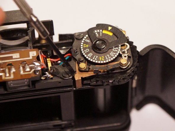

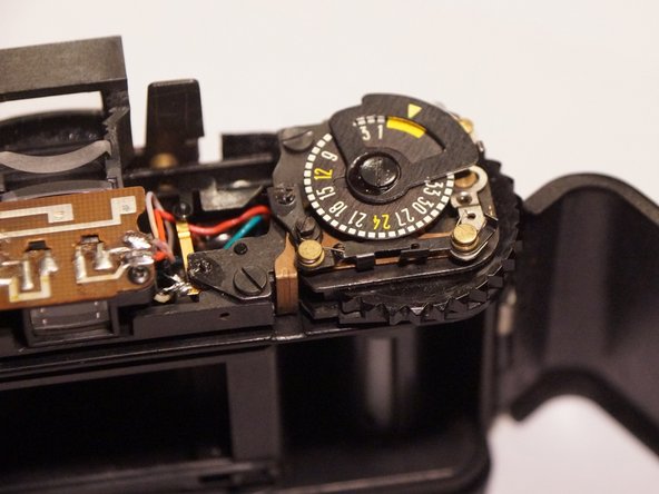

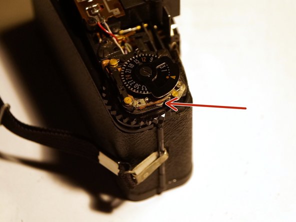

  7. Lomo LC-A: fixing the exposure / picture counter, Automatic counter: crwdns2935265:07crwdnd2935265:01crwdnd2935265:02crwdne2935265:0 Lomo LC-A: fixing the exposure / picture counter, Automatic counter: crwdns2935265:07crwdnd2935265:02crwdnd2935265:02crwdne2935265:0
    • In case the counter does not count at all: check the two black little levers.
    • Pull the trigger a few times and release it by pressing the trigger mechanism (see red arrow in Fig. 1, also works without battery) to see how and whether the counter is working.
    • Move the levers back and forth with a screwdriver; sometimes they are not properly engaged or are in the wrong position.

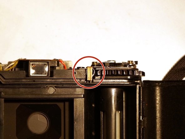

  8. Lomo LC-A: fixing the exposure / picture counter: crwdns2935265:08crwdnd2935265:01crwdnd2935265:03crwdne2935265:0 Lomo LC-A: fixing the exposure / picture counter: crwdns2935265:08crwdnd2935265:02crwdnd2935265:03crwdne2935265:0 Lomo LC-A: fixing the exposure / picture counter: crwdns2935265:08crwdnd2935265:03crwdnd2935265:03crwdne2935265:0

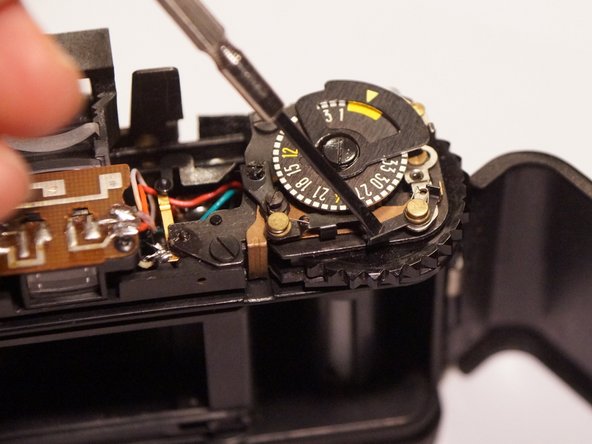

    • In case the counter does not reset to "zero" when opening the back cover:
    • The copper-colored lever is released when the back cover is opened (see the little nose on the cover): this will reset the counter.
    • Move the lever with a screwdriver to check if the counter resets correctly.
    • Check for a smooth gliding mechanics. If the lever does not release by itself, a drop of quality sewing machine oil (no WD 40 or similar!) might help.
  9. Lomo LC-A: fixing the exposure / picture counter, Checking the spring mechanism: crwdns2935265:09crwdnd2935265:01crwdnd2935265:02crwdne2935265:0 Lomo LC-A: fixing the exposure / picture counter, Checking the spring mechanism: crwdns2935265:09crwdnd2935265:02crwdnd2935265:02crwdne2935265:0
    • In this case, the cause was a broken spring. This spring provides sufficient tension to release the lever and reset the counter when the back cover is opened.
    • Figure 2 shows an intact spring from another Lomo.
