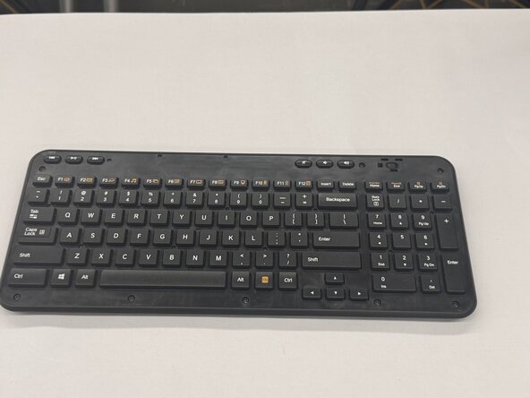

    • Turn the keyboard face down.

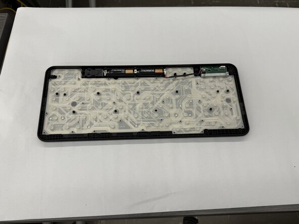

  3. Logitech Wireless K360 Printed Circuit Board (PCB) Replacement: crwdns2935265:03crwdnd2935265:01crwdnd2935265:01crwdne2935265:0
    • Remove the old batteries.
    • Make sure the keyboard turns on and works.
    • Double check that the cover is back on correctly; you don't want it coming off and have the batteries fall out!

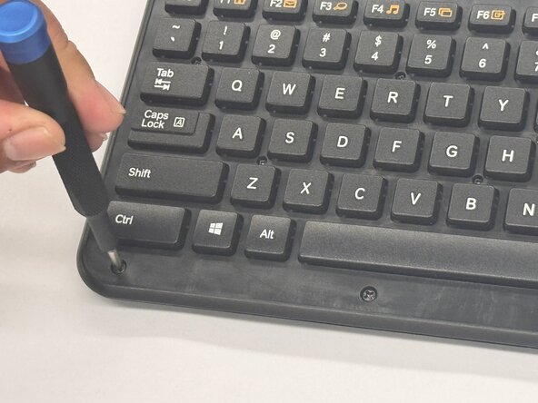

  4. Logitech Wireless K360 Printed Circuit Board (PCB) Replacement, Printed Circuit Board (PCB): crwdns2935265:04crwdnd2935265:01crwdnd2935265:03crwdne2935265:0 Logitech Wireless K360 Printed Circuit Board (PCB) Replacement, Printed Circuit Board (PCB): crwdns2935265:04crwdnd2935265:02crwdnd2935265:03crwdne2935265:0 Logitech Wireless K360 Printed Circuit Board (PCB) Replacement, Printed Circuit Board (PCB): crwdns2935265:04crwdnd2935265:03crwdnd2935265:03crwdne2935265:0
    • Remove the keyboard cover.
    • Remove the screws using a Phillips #0 screwdriver.
    • There are a total of eight 8mm screws and twelve 6mm screws.
  5. Logitech Wireless K360 Printed Circuit Board (PCB) Replacement: crwdns2935265:05crwdnd2935265:01crwdnd2935265:02crwdne2935265:0 Logitech Wireless K360 Printed Circuit Board (PCB) Replacement: crwdns2935265:05crwdnd2935265:02crwdnd2935265:02crwdne2935265:0

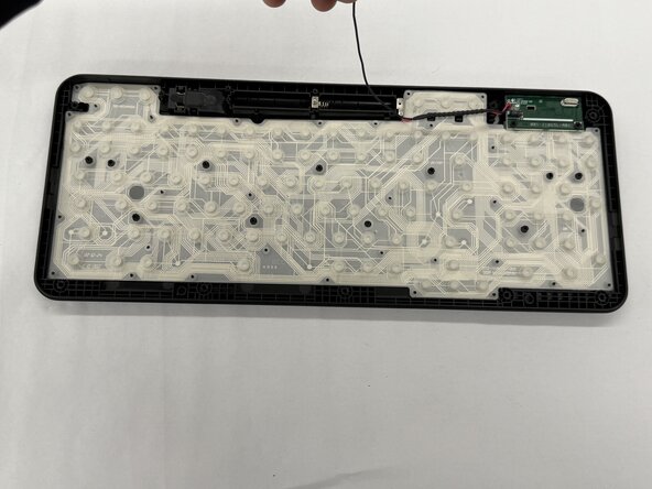

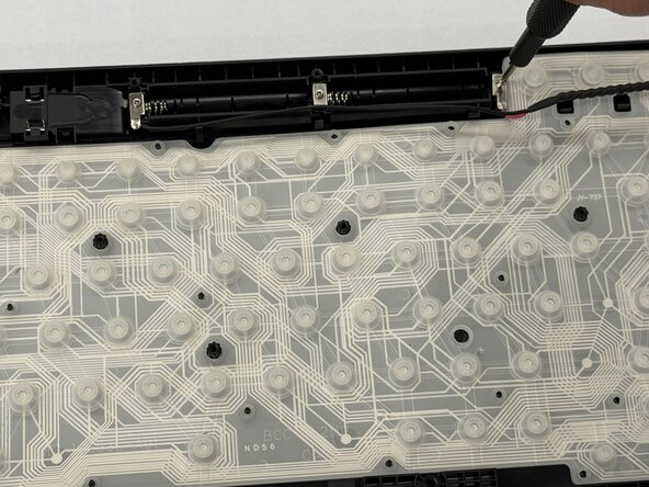

    • Remove the top half of the keyboard carefully.
    • If there are issues removing the top half of the keyboard, you can try using something thin to get into the crevices.
  6. Logitech Wireless K360 Printed Circuit Board (PCB) Replacement: crwdns2935265:06crwdnd2935265:01crwdnd2935265:03crwdne2935265:0 Logitech Wireless K360 Printed Circuit Board (PCB) Replacement: crwdns2935265:06crwdnd2935265:02crwdnd2935265:03crwdne2935265:0 Logitech Wireless K360 Printed Circuit Board (PCB) Replacement: crwdns2935265:06crwdnd2935265:03crwdnd2935265:03crwdne2935265:0

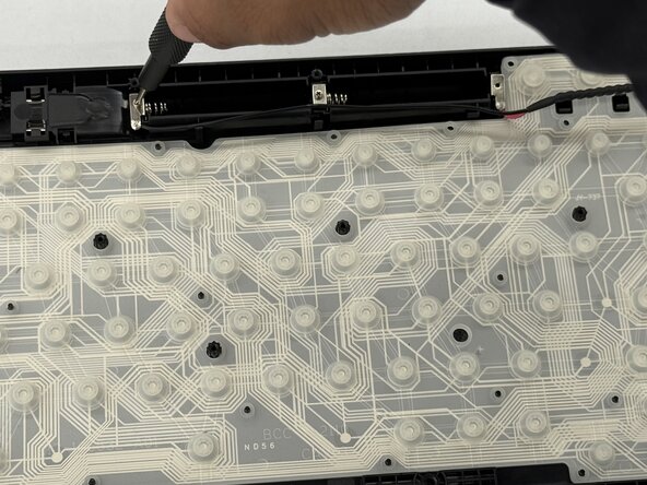

    • Unscrew the two 2.0 mm silver screws using a Phillips #0 screwdriver.
  7. Logitech Wireless K360 Printed Circuit Board (PCB) Replacement: crwdns2935265:07crwdnd2935265:01crwdnd2935265:03crwdne2935265:0 Logitech Wireless K360 Printed Circuit Board (PCB) Replacement: crwdns2935265:07crwdnd2935265:02crwdnd2935265:03crwdne2935265:0 Logitech Wireless K360 Printed Circuit Board (PCB) Replacement: crwdns2935265:07crwdnd2935265:03crwdnd2935265:03crwdne2935265:0
    • Unscrew the two 2.0 mm silver screws on either side of the printed circuit board (PCB) using a Phillips #0 screwdriver.

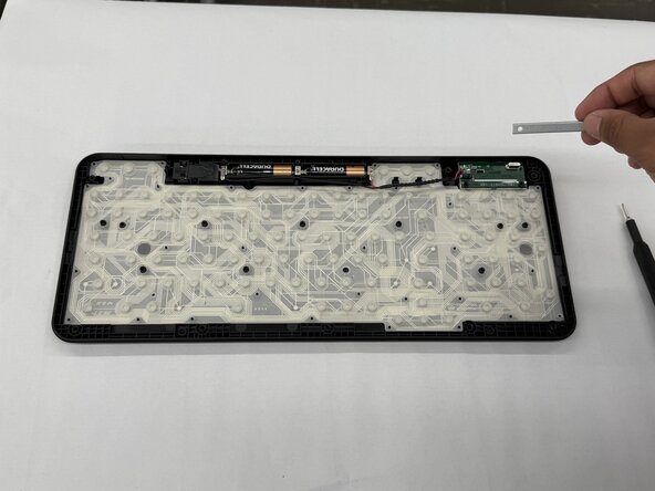

  8. Logitech Wireless K360 Printed Circuit Board (PCB) Replacement: crwdns2935265:08crwdnd2935265:01crwdnd2935265:03crwdne2935265:0 Logitech Wireless K360 Printed Circuit Board (PCB) Replacement: crwdns2935265:08crwdnd2935265:02crwdnd2935265:03crwdne2935265:0 Logitech Wireless K360 Printed Circuit Board (PCB) Replacement: crwdns2935265:08crwdnd2935265:03crwdnd2935265:03crwdne2935265:0

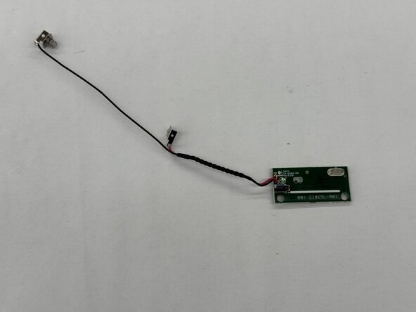

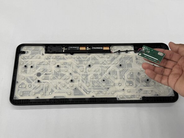

    • Lift the entire printed circuit board (PCB) out of the panel.
