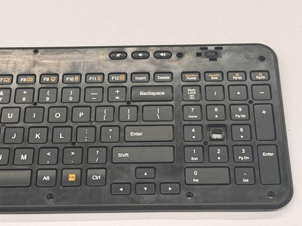

    • Use a Jimmy to pry off the keyboard cover.
    • When reapplying the keyboard cover, glue may be required to keep adhesive properties.
  2. Logitech Wireless K360 Key Cap Replacement: crwdns2935265:02crwdnd2935265:01crwdnd2935265:02crwdne2935265:0 Logitech Wireless K360 Key Cap Replacement: crwdns2935265:02crwdnd2935265:02crwdnd2935265:02crwdne2935265:0
    • Remove the eight 6 mm screws using a Phillips #0 screwdriver.
  3. Logitech Wireless K360 Key Cap Replacement: crwdns2935265:03crwdnd2935265:01crwdnd2935265:03crwdne2935265:0 Logitech Wireless K360 Key Cap Replacement: crwdns2935265:03crwdnd2935265:02crwdnd2935265:03crwdne2935265:0 Logitech Wireless K360 Key Cap Replacement: crwdns2935265:03crwdnd2935265:03crwdnd2935265:03crwdne2935265:0
    • Remove the top half of the keyboard.
    • If there are issues removing the top half of the keyboard you can try using something thin to get into the crevices.
  4. Logitech Wireless K360 Key Cap Replacement: crwdns2935265:04crwdnd2935265:01crwdnd2935265:03crwdne2935265:0 Logitech Wireless K360 Key Cap Replacement: crwdns2935265:04crwdnd2935265:02crwdnd2935265:03crwdne2935265:0 Logitech Wireless K360 Key Cap Replacement: crwdns2935265:04crwdnd2935265:03crwdnd2935265:03crwdne2935265:0
    • Flip the top half of the keyboard over.
    • Use tweezers or an iFixit opening tool to pinch the damaged key cap out of the top half.
