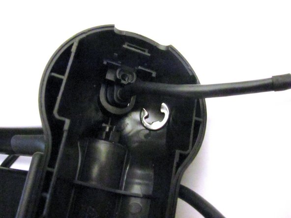

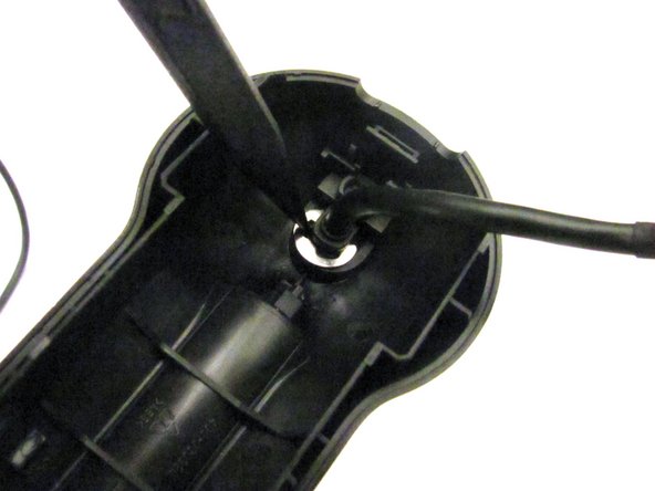

    1. Logitech Webcam Pro 9000 USB Cable Replacement, USB Cable: crwdns2935265:05crwdnd2935265:01crwdnd2935265:03crwdne2935265:0 Logitech Webcam Pro 9000 USB Cable Replacement, USB Cable: crwdns2935265:05crwdnd2935265:02crwdnd2935265:03crwdne2935265:0 Logitech Webcam Pro 9000 USB Cable Replacement, USB Cable: crwdns2935265:05crwdnd2935265:03crwdnd2935265:03crwdne2935265:0
      • Wedge the pointy end of the spudger between the sliver E-ring and USB attachment base to extract the E-ring and release the USB cable.
    2. Logitech Webcam Pro 9000 USB Cable Replacement: crwdns2935265:06crwdnd2935265:01crwdnd2935265:02crwdne2935265:0 Logitech Webcam Pro 9000 USB Cable Replacement: crwdns2935265:06crwdnd2935265:02crwdnd2935265:02crwdne2935265:0
      • Feed the end of the disconnected USB cable through the back cover.
