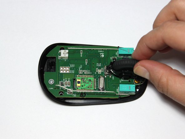

  6. Logitech V220 - Cordless Optical Mouse Scroll Wheel Replacement, Removing the Scroll Wheel: crwdns2935265:06crwdnd2935265:01crwdnd2935265:03crwdne2935265:0 Logitech V220 - Cordless Optical Mouse Scroll Wheel Replacement, Removing the Scroll Wheel: crwdns2935265:06crwdnd2935265:02crwdnd2935265:03crwdne2935265:0 Logitech V220 - Cordless Optical Mouse Scroll Wheel Replacement, Removing the Scroll Wheel: crwdns2935265:06crwdnd2935265:03crwdnd2935265:03crwdne2935265:0
    • Locate the one, scroll wheel, #0 Phillips screw near the very front edge of the mouse.
    • Turn the mouse 90 degrees clockwise.
    • While supporting the rear of the mouse base, unscrew the #0 Phillips scroll wheel screw.
    • Set the screw to the side for reassembly.
    • Once the scroll wheel screw is fully removed, manually extract the scroll wheel and spring assembly.
    • Set the remains of the base of the mouse to the side.
