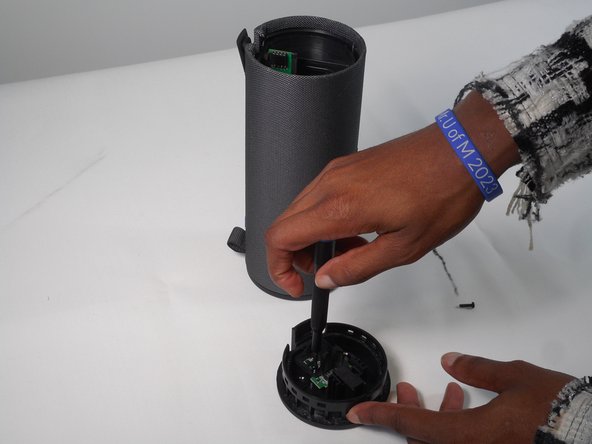

      • To access all internal components, first flip the speaker upwards to where you can see the base.
      • Place your blue iFixit opening picks inside the gap between the speaker and the base to act as a lever when opening the speaker.
    2. Logitech UE MegaBoom 3 USB Port Replacement: crwdns2935265:02crwdnd2935265:01crwdnd2935265:03crwdne2935265:0 Logitech UE MegaBoom 3 USB Port Replacement: crwdns2935265:02crwdnd2935265:02crwdnd2935265:03crwdne2935265:0 Logitech UE MegaBoom 3 USB Port Replacement: crwdns2935265:02crwdnd2935265:03crwdnd2935265:03crwdne2935265:0
      • Using the flat head #4.5 screw driver, carefully lever and rotate the driver around the edge of the speaker to enlarge the gap further.
      • Here, it is ideal to use a spudger as opposed to the flathead screwdriver, however, the flathead makes it so much easier to pry off the cap.
      • Pry off the base of the speaker and remove the end cap.

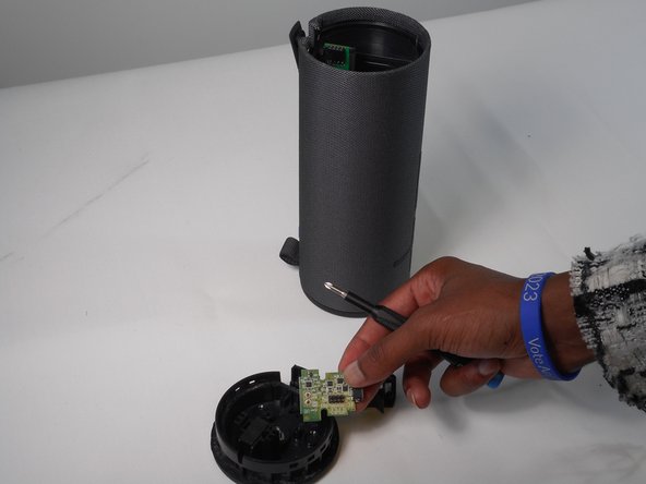

    1. Logitech UE MegaBoom 3 USB Port Replacement, USB Port: crwdns2935265:03crwdnd2935265:01crwdnd2935265:03crwdne2935265:0 Logitech UE MegaBoom 3 USB Port Replacement, USB Port: crwdns2935265:03crwdnd2935265:02crwdnd2935265:03crwdne2935265:0 Logitech UE MegaBoom 3 USB Port Replacement, USB Port: crwdns2935265:03crwdnd2935265:03crwdnd2935265:03crwdne2935265:0
      • To remove the plastic frame that’s covering the charging board, use a Phillips #0 to remove both 2.4 mm screws.
      • Replace the charging port.
