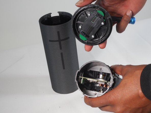

    2. Logitech UE MegaBoom 3 Motherboard Replacement: crwdns2935265:04crwdnd2935265:01crwdnd2935265:03crwdne2935265:0 Logitech UE MegaBoom 3 Motherboard Replacement: crwdns2935265:04crwdnd2935265:02crwdnd2935265:03crwdne2935265:0 Logitech UE MegaBoom 3 Motherboard Replacement: crwdns2935265:04crwdnd2935265:03crwdnd2935265:03crwdne2935265:0
      • Remove the top half of the speaker using the 4.5 mm flat head screwdriver.
      • Now remove the top of the speaker by prying and releasing the tab around the cap using the same screwdriver.
    3. Logitech UE MegaBoom 3 Motherboard Replacement: crwdns2935265:05crwdnd2935265:01crwdnd2935265:03crwdne2935265:0 Logitech UE MegaBoom 3 Motherboard Replacement: crwdns2935265:05crwdnd2935265:02crwdnd2935265:03crwdne2935265:0 Logitech UE MegaBoom 3 Motherboard Replacement: crwdns2935265:05crwdnd2935265:03crwdnd2935265:03crwdne2935265:0
      • With the cap removed, using Phillips #0 screwdriver remove all four 2.0 mm screws to take off the control board.
      • Now you can replace the power button control board.

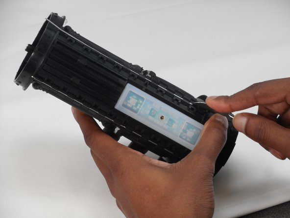

    1. Logitech UE MegaBoom 3 Motherboard Replacement, Motherboard: crwdns2935265:010crwdnd2935265:01crwdnd2935265:03crwdne2935265:0 Logitech UE MegaBoom 3 Motherboard Replacement, Motherboard: crwdns2935265:010crwdnd2935265:02crwdnd2935265:03crwdne2935265:0 Logitech UE MegaBoom 3 Motherboard Replacement, Motherboard: crwdns2935265:010crwdnd2935265:03crwdnd2935265:03crwdne2935265:0
      • Using the metal spudger, remove the volume control board to prevent any damage.
      • Remove the clear silicone cover to access the board.
      • Carefully pull off the board and disconnect it from the motherboard.
    2. Logitech UE MegaBoom 3 Motherboard Replacement: crwdns2935265:011crwdnd2935265:01crwdnd2935265:02crwdne2935265:0 Logitech UE MegaBoom 3 Motherboard Replacement: crwdns2935265:011crwdnd2935265:02crwdnd2935265:02crwdne2935265:0
      • Slide out the mother board gently.
