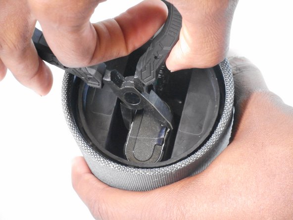

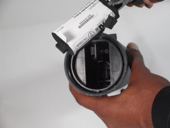

    1. Logitech UE MegaBoom 3 Battery Replacement, Battery: crwdns2935265:03crwdnd2935265:01crwdnd2935265:03crwdne2935265:0 Logitech UE MegaBoom 3 Battery Replacement, Battery: crwdns2935265:03crwdnd2935265:02crwdnd2935265:03crwdne2935265:0 Logitech UE MegaBoom 3 Battery Replacement, Battery: crwdns2935265:03crwdnd2935265:03crwdnd2935265:03crwdne2935265:0
      • Remove the lithium-ion battery from the inside of the speaker by gripping the battery using the plyers.
      • Here, it is ideal to use a tweezers as opposed to the plyers, however, the plyers makes it so much easier to take out the battery.
      • The battery should slide out as you pull against it with the plyers.
      • Remove the battery.
