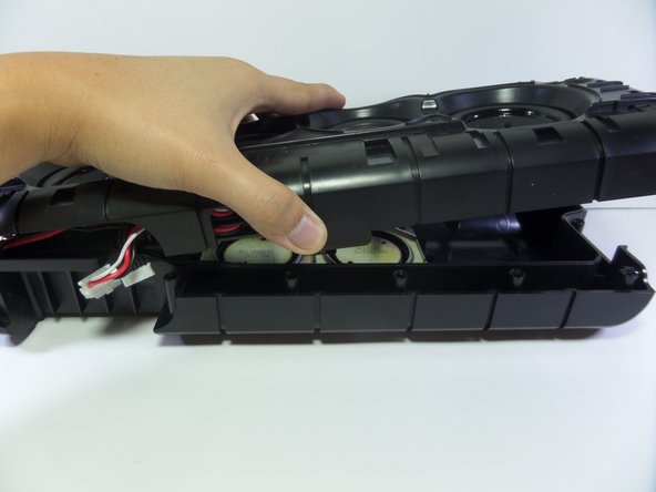

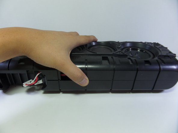

    • Remove the fifteen 13.0 mm Phillips #2 screws from the side of the device containing two speakers.
    • Separate the two halves by gently pulling them apart.
