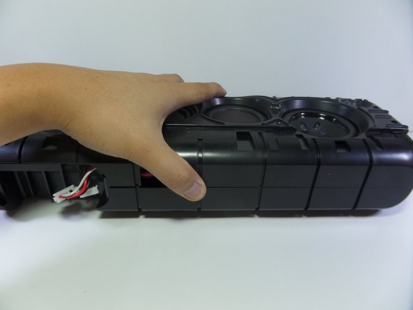

  14. Logitech UE Boombox Speaker Replacement, Speaker: crwdns2935265:014crwdnd2935265:01crwdnd2935265:03crwdne2935265:0 Logitech UE Boombox Speaker Replacement, Speaker: crwdns2935265:014crwdnd2935265:02crwdnd2935265:03crwdne2935265:0 Logitech UE Boombox Speaker Replacement, Speaker: crwdns2935265:014crwdnd2935265:03crwdnd2935265:03crwdne2935265:0
    • Remove the fifteen 13.0 mm screws with a #0 Phillips from the side of the device containing two speakers.
    • Separate the two halves by gently pulling them apart.
    • The screws at this step are embedded deep within the device so make sure your screw driver is long.

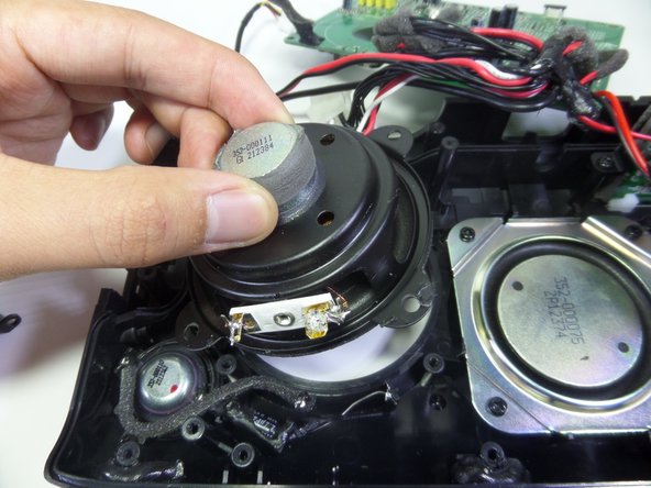

    • Remove the four 7.0 mm screws with a Phillips #2.
  18. Logitech UE Boombox Speaker Replacement: crwdns2935265:018crwdnd2935265:01crwdnd2935265:02crwdne2935265:0 Logitech UE Boombox Speaker Replacement: crwdns2935265:018crwdnd2935265:02crwdnd2935265:02crwdne2935265:0
    • Lift the speaker out of the device using your fingers.

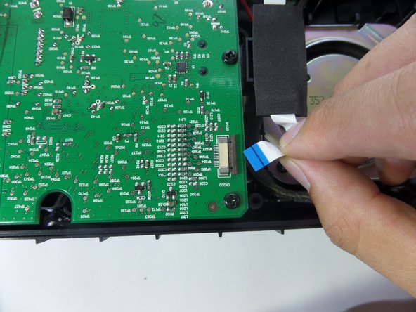

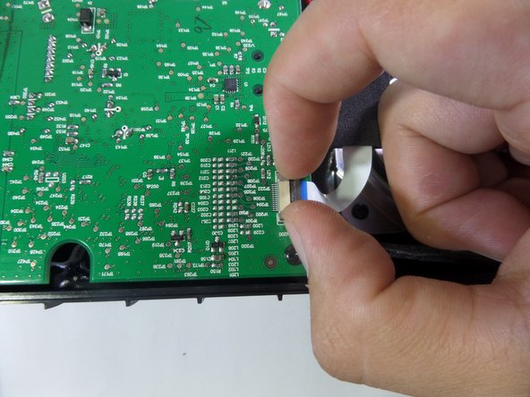

  19. Logitech UE Boombox Speaker Replacement: crwdns2935265:019crwdnd2935265:01crwdnd2935265:03crwdne2935265:0 Logitech UE Boombox Speaker Replacement: crwdns2935265:019crwdnd2935265:02crwdnd2935265:03crwdne2935265:0 Logitech UE Boombox Speaker Replacement: crwdns2935265:019crwdnd2935265:03crwdnd2935265:03crwdne2935265:0

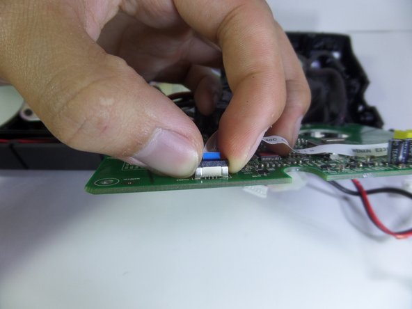

    • Pull up on the lock to detach the band connector from the motherboard.
  20. Logitech UE Boombox Speaker Replacement: crwdns2935265:020crwdnd2935265:01crwdnd2935265:01crwdne2935265:0
    • Remove five 7.0 mm screws on the motherboard with a Phillips #2.

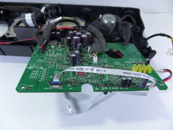

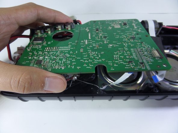

  21. Logitech UE Boombox Speaker Replacement: crwdns2935265:021crwdnd2935265:01crwdnd2935265:03crwdne2935265:0 Logitech UE Boombox Speaker Replacement: crwdns2935265:021crwdnd2935265:02crwdnd2935265:03crwdne2935265:0 Logitech UE Boombox Speaker Replacement: crwdns2935265:021crwdnd2935265:03crwdnd2935265:03crwdne2935265:0
    • Lift the motherboard with your fingers.
    • Flip over to reveal the underside.
    • Motherboard will still be attached to the device.

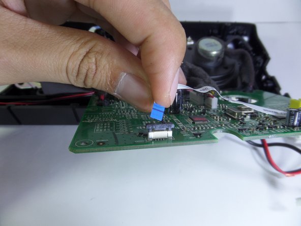

  22. Logitech UE Boombox Speaker Replacement: crwdns2935265:022crwdnd2935265:01crwdnd2935265:03crwdne2935265:0 Logitech UE Boombox Speaker Replacement: crwdns2935265:022crwdnd2935265:02crwdnd2935265:03crwdne2935265:0 Logitech UE Boombox Speaker Replacement: crwdns2935265:022crwdnd2935265:03crwdnd2935265:03crwdne2935265:0
    • Pull up on the lock of the band connector to detach it from the motherboard.

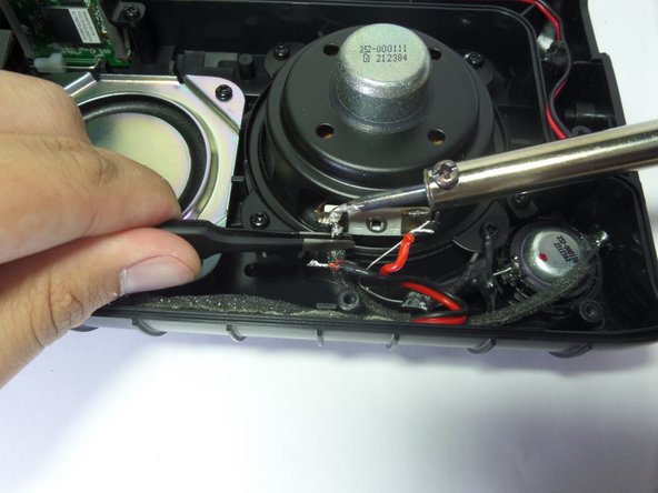

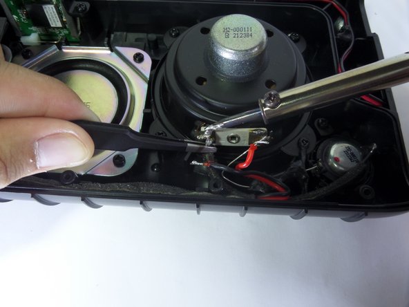

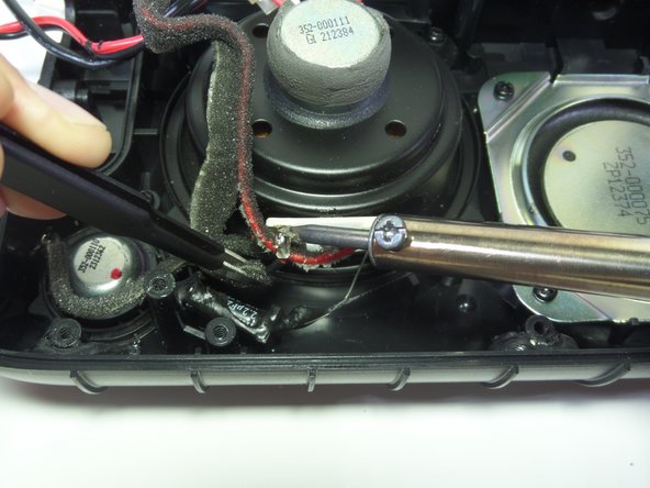

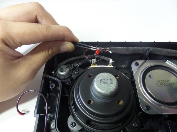

  23. Logitech UE Boombox Speaker Replacement: crwdns2935265:023crwdnd2935265:01crwdnd2935265:03crwdne2935265:0 Logitech UE Boombox Speaker Replacement: crwdns2935265:023crwdnd2935265:02crwdnd2935265:03crwdne2935265:0 Logitech UE Boombox Speaker Replacement: crwdns2935265:023crwdnd2935265:03crwdnd2935265:03crwdne2935265:0
    • Desolder all four wires connecting the speaker.
    • One red and one black wire are located on each side of speaker.
  24. Logitech UE Boombox Speaker Replacement: crwdns2935265:024crwdnd2935265:01crwdnd2935265:01crwdne2935265:0

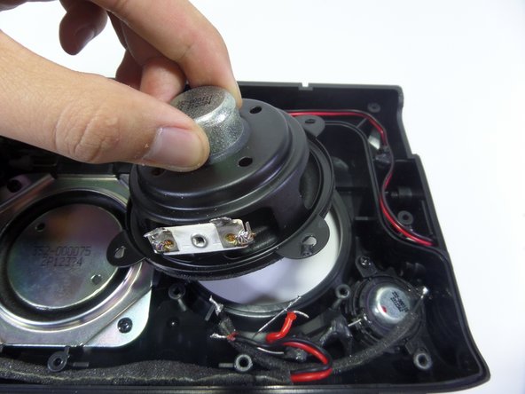

    • Remove four 7.0 mm screws with a Phillips #2.
  25. Logitech UE Boombox Speaker Replacement: crwdns2935265:025crwdnd2935265:01crwdnd2935265:02crwdne2935265:0 Logitech UE Boombox Speaker Replacement: crwdns2935265:025crwdnd2935265:02crwdnd2935265:02crwdne2935265:0
