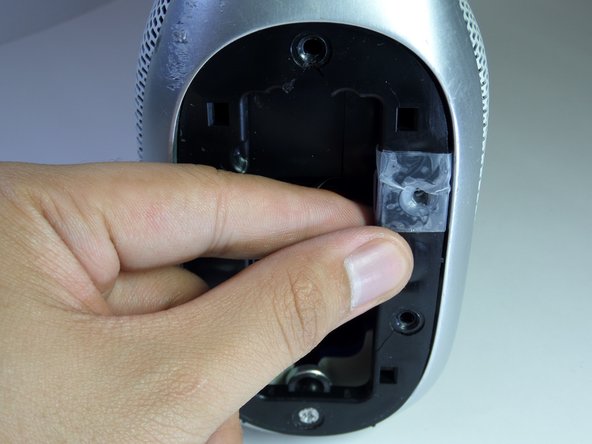

    • Use a metal spudger to pry open the power button cover.
    • Once the power button cover is slightly opened, use your fingers to remove the power button cover.

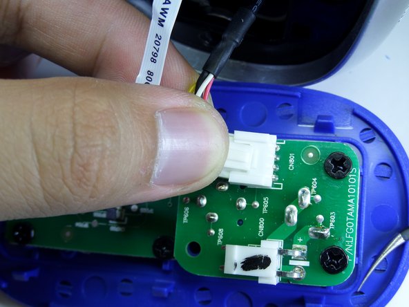

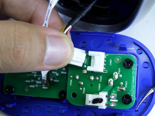

  2. Logitech UE Boombox Speaker Grille Replacement: crwdns2935265:02crwdnd2935265:01crwdnd2935265:03crwdne2935265:0 Logitech UE Boombox Speaker Grille Replacement: crwdns2935265:02crwdnd2935265:02crwdnd2935265:03crwdne2935265:0 Logitech UE Boombox Speaker Grille Replacement: crwdns2935265:02crwdnd2935265:03crwdnd2935265:03crwdne2935265:0
    • Press firmly on the end of the latch and pull the two-wire connector away from the base to separate.
  3. Logitech UE Boombox Speaker Grille Replacement: crwdns2935265:03crwdnd2935265:01crwdnd2935265:03crwdne2935265:0 Logitech UE Boombox Speaker Grille Replacement: crwdns2935265:03crwdnd2935265:02crwdnd2935265:03crwdne2935265:0 Logitech UE Boombox Speaker Grille Replacement: crwdns2935265:03crwdnd2935265:03crwdnd2935265:03crwdne2935265:0
    • Firmly press on the end of the latch and pull the four-wire connector away from the base to separate.

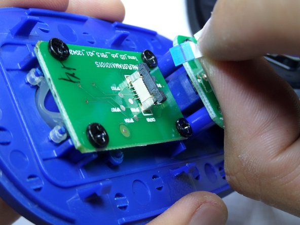

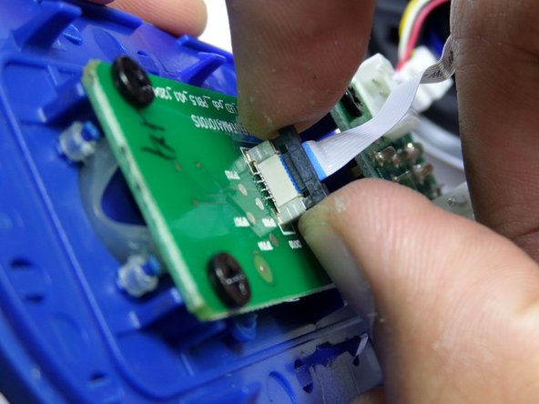

  4. Logitech UE Boombox Speaker Grille Replacement: crwdns2935265:04crwdnd2935265:01crwdnd2935265:03crwdne2935265:0 Logitech UE Boombox Speaker Grille Replacement: crwdns2935265:04crwdnd2935265:02crwdnd2935265:03crwdne2935265:0 Logitech UE Boombox Speaker Grille Replacement: crwdns2935265:04crwdnd2935265:03crwdnd2935265:03crwdne2935265:0
    • Lightly, pry up on each side of the black band connector lock using your fingertips.
    • Once unlocked, pull straight up on the connector to remove.

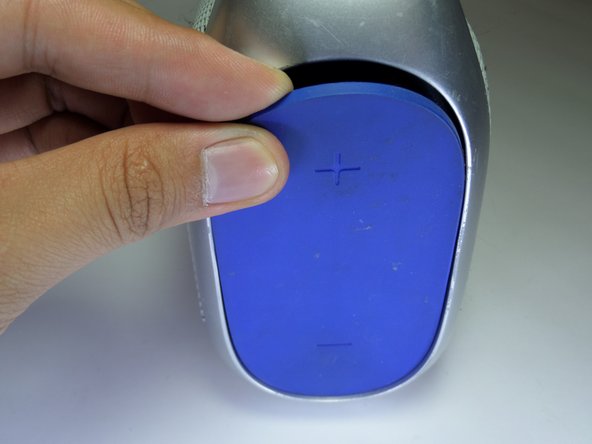

  6. Logitech UE Boombox Speaker Grille Replacement: crwdns2935265:06crwdnd2935265:01crwdnd2935265:02crwdne2935265:0 Logitech UE Boombox Speaker Grille Replacement: crwdns2935265:06crwdnd2935265:02crwdnd2935265:02crwdne2935265:0
    • On the opposite side of the device, pry open the volume rocker with a metal spudger.
    • Remove the panel with your fingers once the volume rocker is slightly opened.

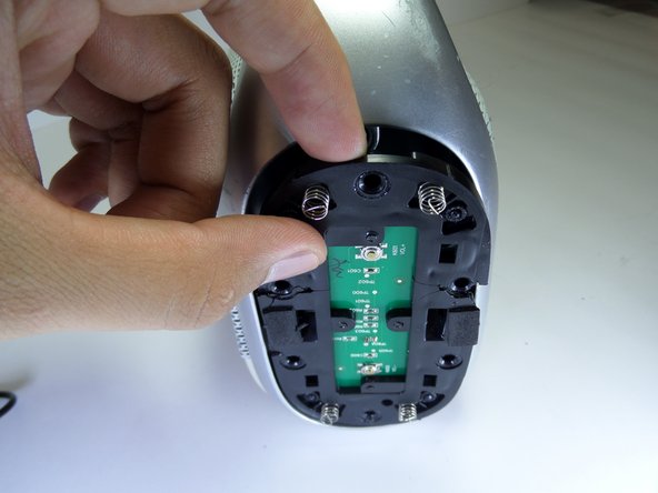

  7. Logitech UE Boombox Speaker Grille Replacement: crwdns2935265:07crwdnd2935265:01crwdnd2935265:03crwdne2935265:0 Logitech UE Boombox Speaker Grille Replacement: crwdns2935265:07crwdnd2935265:02crwdnd2935265:03crwdne2935265:0 Logitech UE Boombox Speaker Grille Replacement: crwdns2935265:07crwdnd2935265:03crwdnd2935265:03crwdne2935265:0
    • Remove the five black 14mm Phillips #2 screws from the black plastic side panel.
    • Remove the one silver16 mm Phillips #2 screw from the black plastic side panel.
    • Once all screws are removed, take the screw panel out of the device to gain access to the back of the panel.

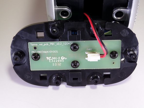

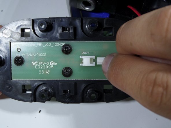

  8. Logitech UE Boombox Speaker Grille Replacement: crwdns2935265:08crwdnd2935265:01crwdnd2935265:02crwdne2935265:0 Logitech UE Boombox Speaker Grille Replacement: crwdns2935265:08crwdnd2935265:02crwdnd2935265:02crwdne2935265:0
    • Firmly press on the end of the latch and pull the two-wire connector away from the base.

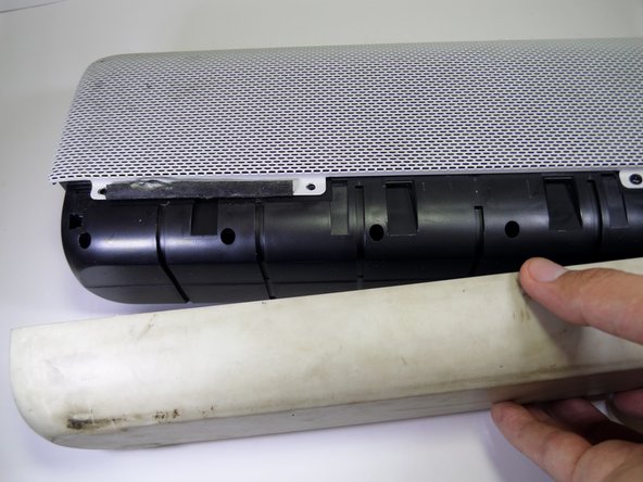

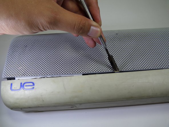

  10. Logitech UE Boombox Speaker Grille Replacement: crwdns2935265:010crwdnd2935265:01crwdnd2935265:02crwdne2935265:0 Logitech UE Boombox Speaker Grille Replacement: crwdns2935265:010crwdnd2935265:02crwdnd2935265:02crwdne2935265:0
    • Use a metal spudger to pry the rubber base apart from the aluminum grille.
  11. Logitech UE Boombox Speaker Grille Replacement: crwdns2935265:011crwdnd2935265:01crwdnd2935265:02crwdne2935265:0 Logitech UE Boombox Speaker Grille Replacement: crwdns2935265:011crwdnd2935265:02crwdnd2935265:02crwdne2935265:0
    • Pull the rubber base away from the boombox.

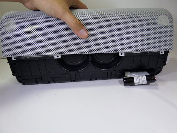

  13. Logitech UE Boombox Speaker Grille Replacement: crwdns2935265:013crwdnd2935265:01crwdnd2935265:03crwdne2935265:0 Logitech UE Boombox Speaker Grille Replacement: crwdns2935265:013crwdnd2935265:02crwdnd2935265:03crwdne2935265:0 Logitech UE Boombox Speaker Grille Replacement: crwdns2935265:013crwdnd2935265:03crwdnd2935265:03crwdne2935265:0
    • Pull vertically on the speaker grille to remove it from the boombox.
