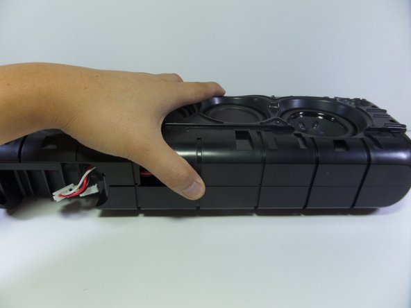

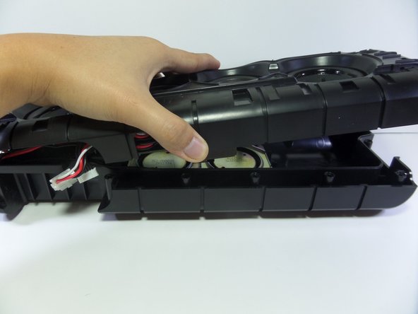

  14. Logitech UE Boombox Bluetooth Adapter Replacement, Bluetooth Adapter: crwdns2935265:014crwdnd2935265:01crwdnd2935265:03crwdne2935265:0 Logitech UE Boombox Bluetooth Adapter Replacement, Bluetooth Adapter: crwdns2935265:014crwdnd2935265:02crwdnd2935265:03crwdne2935265:0 Logitech UE Boombox Bluetooth Adapter Replacement, Bluetooth Adapter: crwdns2935265:014crwdnd2935265:03crwdnd2935265:03crwdne2935265:0
    • Remove the fifteen 13.0mm Phillips #2 screws from the side of the device containing two speakers.
    • Separate the two halves by gently pulling them apart.
    • The screws at this step are embedded deep within the device so make sure your screwdriver is long.

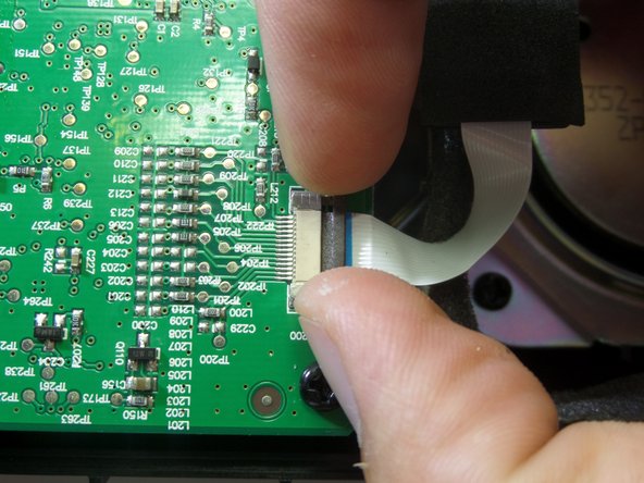

  15. Logitech UE Boombox Bluetooth Adapter Replacement: crwdns2935265:015crwdnd2935265:01crwdnd2935265:03crwdne2935265:0 Logitech UE Boombox Bluetooth Adapter Replacement: crwdns2935265:015crwdnd2935265:02crwdnd2935265:03crwdne2935265:0 Logitech UE Boombox Bluetooth Adapter Replacement: crwdns2935265:015crwdnd2935265:03crwdnd2935265:03crwdne2935265:0
    • Pull up on the lock connecting the band connector to the motherboard with your finger tips.
    • Detach the band connector gently from the motherboard.
