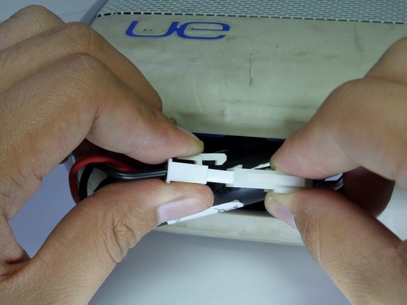

    • Place the Boombox on the side with its bottom facing you.
    • Remove one 8 mm Phillips #2 screw.
  2. Logitech UE Boombox Battery Replacement: crwdns2935265:02crwdnd2935265:01crwdnd2935265:01crwdne2935265:0
    • Pry off the rubber battery cover using a metal spudger.
  3. Logitech UE Boombox Battery Replacement: crwdns2935265:03crwdnd2935265:01crwdnd2935265:02crwdne2935265:0 Logitech UE Boombox Battery Replacement: crwdns2935265:03crwdnd2935265:02crwdnd2935265:02crwdne2935265:0
    • Expose the battery by gently pulling it away from the battery cavity.
  4. Logitech UE Boombox Battery Replacement: crwdns2935265:04crwdnd2935265:01crwdnd2935265:03crwdne2935265:0 Logitech UE Boombox Battery Replacement: crwdns2935265:04crwdnd2935265:02crwdnd2935265:03crwdne2935265:0 Logitech UE Boombox Battery Replacement: crwdns2935265:04crwdnd2935265:03crwdnd2935265:03crwdne2935265:0
    • Firmly press down on the end of the latch and pull connector apart.
