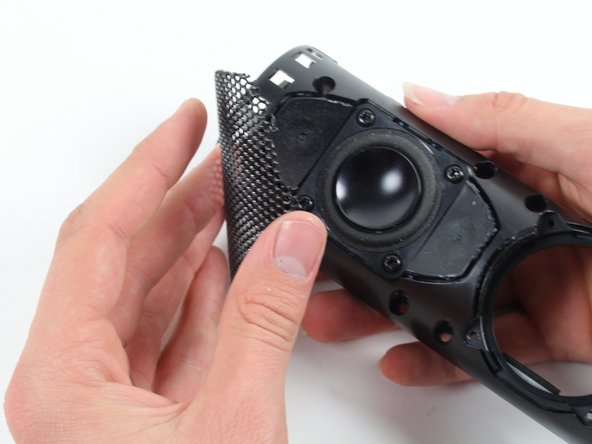

  18. Logitech UE Boom Speaker Replacement: crwdns2935265:018crwdnd2935265:01crwdnd2935265:02crwdne2935265:0 Logitech UE Boom Speaker Replacement: crwdns2935265:018crwdnd2935265:02crwdnd2935265:02crwdne2935265:0
    • Remove the panel covering the speaker with the spudger. Be careful while doing this, as it is a very fragile and brittle metal panel.

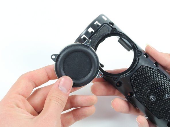

  19. Logitech UE Boom Speaker Replacement: crwdns2935265:019crwdnd2935265:01crwdnd2935265:01crwdne2935265:0
    • Unscrew the bolts holding the speaker in after removing the panel covering the speakers.
  20. Logitech UE Boom Speaker Replacement: crwdns2935265:020crwdnd2935265:01crwdnd2935265:02crwdne2935265:0 Logitech UE Boom Speaker Replacement: crwdns2935265:020crwdnd2935265:02crwdnd2935265:02crwdne2935265:0
    • Gently pull the speaker off of the case after unscrewing the screws holding it in place.
  21. Logitech UE Boom Speaker Replacement: crwdns2935265:021crwdnd2935265:01crwdnd2935265:01crwdne2935265:0
    • Start unscrewing the screws on the second speaker (the process for removing the panels is the same for both speakers!).
  22. Logitech UE Boom Speaker Replacement: crwdns2935265:022crwdnd2935265:01crwdnd2935265:01crwdne2935265:0
    • Remove the speaker from the casing as was done previously with the other speaker.
  23. Logitech UE Boom Speaker Replacement: crwdns2935265:023crwdnd2935265:01crwdnd2935265:02crwdne2935265:0 Logitech UE Boom Speaker Replacement: crwdns2935265:023crwdnd2935265:02crwdnd2935265:02crwdne2935265:0
    • Gently unplug the speaker from the motherboard after removing it from its place in the casing of the device.
  24. Logitech UE Boom Speaker Replacement: crwdns2935265:024crwdnd2935265:01crwdnd2935265:02crwdne2935265:0 Logitech UE Boom Speaker Replacement: crwdns2935265:024crwdnd2935265:02crwdnd2935265:02crwdne2935265:0
    • Gently unplug the other speaker from the motherboard after removing it from its place in the casing of the device.
    • After this, you will have completely removed the speakers from the device!

How many speakers are inside exactly, 2 or 4 ? I didn't understand if there are 2 per side or not...
I don't have sound on a side of my speaker and I don't now if this is normal (it is new)
Pixedy - crwdns2934203:0crwdne2934203:0
There are 2 speakers and 2 passive resonators, the 2 on the top are speakers while the 2 on the bottom are basically speakers without coils, they are just cones that rely on the pressure and vibration inside of the device generated by the real speakers on top to vibrate themselves and increase bass/low-end presence.
frankg65tg -
