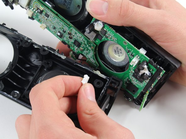

  17. Logitech UE Boom Motherboard Replacement, Motherboard: crwdns2935265:017crwdnd2935265:01crwdnd2935265:02crwdne2935265:0 Logitech UE Boom Motherboard Replacement, Motherboard: crwdns2935265:017crwdnd2935265:02crwdnd2935265:02crwdne2935265:0
    • Remove the speaker by pulling it from the terminal as marked in the picture.
  18. Logitech UE Boom Motherboard Replacement: crwdns2935265:018crwdnd2935265:01crwdnd2935265:02crwdne2935265:0 Logitech UE Boom Motherboard Replacement: crwdns2935265:018crwdnd2935265:02crwdnd2935265:02crwdne2935265:0
    • Remove the second speaker by pulling it from the terminal as marked in the picture.

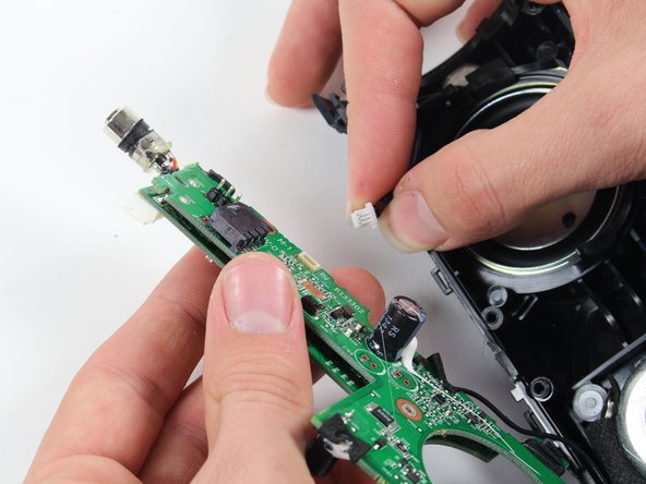

  19. Logitech UE Boom Motherboard Replacement: crwdns2935265:019crwdnd2935265:01crwdnd2935265:02crwdne2935265:0 Logitech UE Boom Motherboard Replacement: crwdns2935265:019crwdnd2935265:02crwdnd2935265:02crwdne2935265:0
    • Finally, remove the motherboard completely by pulling it from the terminal as marked in the picture.
