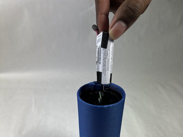

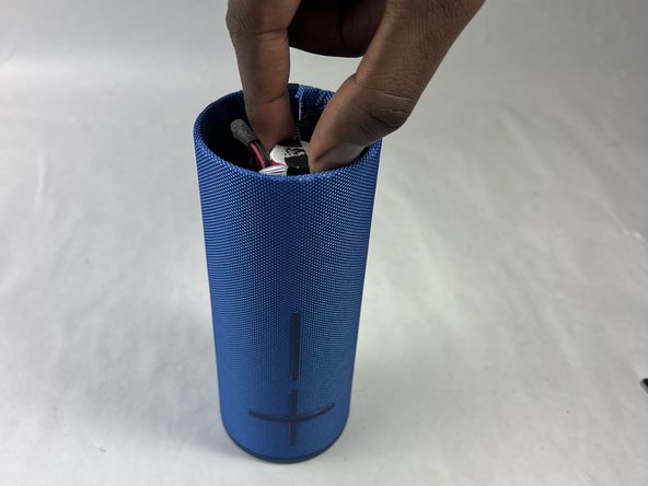

    1. Logitech UE Boom 3 Battery Replacement, Battery: crwdns2935265:03crwdnd2935265:01crwdnd2935265:03crwdne2935265:0 Logitech UE Boom 3 Battery Replacement, Battery: crwdns2935265:03crwdnd2935265:02crwdnd2935265:03crwdne2935265:0 Logitech UE Boom 3 Battery Replacement, Battery: crwdns2935265:03crwdnd2935265:03crwdnd2935265:03crwdne2935265:0
      • Remove the adhesive strap holding the battery in place.
      • It is sticky and tightly bounded, but removal is necessary.
      • Pull out the battery by hand until it is out of the casing and being held by the cable only.
    2. Logitech UE Boom 3 Battery Replacement: crwdns2935265:04crwdnd2935265:01crwdnd2935265:02crwdne2935265:0 Logitech UE Boom 3 Battery Replacement: crwdns2935265:04crwdnd2935265:02crwdnd2935265:02crwdne2935265:0
      • The battery will still be attached to motherboard via cable.
      • Carefully press down on the lever on the end of the cable and disconnect it from the motherboard.
      • This cable is intricate and is susceptible to damage beyond repair. Be extra careful to precisely insert and remove the cable as bending the pins can result in damage.
      • Remove the battery from the motherboard.
