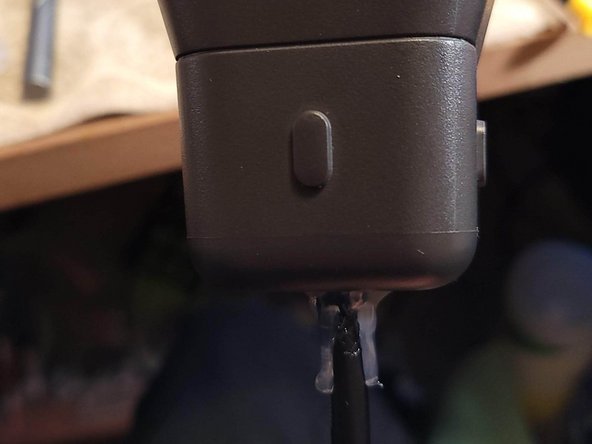

Logitech StreamCam (‎960-001286) USB-C Cable Replacement
  1. Logitech StreamCam (‎960-001286) USB-C Cable Replacement, USB-C Cable (board-to-computer): crwdns2935265:01crwdnd2935265:01crwdnd2935265:02crwdne2935265:0 Logitech StreamCam (‎960-001286) USB-C Cable Replacement, USB-C Cable (board-to-computer): crwdns2935265:01crwdnd2935265:02crwdnd2935265:02crwdne2935265:0
    • Be mindful of keeping the lens glass away from abrasives when disassembling. Turn the camera over and use your plastic spudger (pry tool) to pop out the plastic ring obscuring two small screws.
    • NOTE: many fixers may find that replacing only the distal USB-C plug is needed. In that case, you needn't open the camera or replace the cable -- just skip to the wiring explanation in step 4, and get a new USB 3.x type-A or type-C male plug.

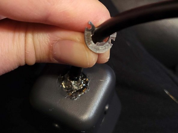

  2. Logitech StreamCam (‎960-001286) USB-C Cable Replacement, Removing cable-housing retention: crwdns2935265:02crwdnd2935265:01crwdnd2935265:03crwdne2935265:0 Logitech StreamCam (‎960-001286) USB-C Cable Replacement, Removing cable-housing retention: crwdns2935265:02crwdnd2935265:02crwdnd2935265:03crwdne2935265:0 Logitech StreamCam (‎960-001286) USB-C Cable Replacement, Removing cable-housing retention: crwdns2935265:02crwdnd2935265:03crwdnd2935265:03crwdne2935265:0
    • Once the screws are removed, the retention ring easily separates from the cable moulding with firm prying or pulling pressure. It's a C-clip with some light adhesive facing outward.
    • After the retention clip is out, peering into the housing will reveal two identical 000 screws that hold the camera subframe to the outer shell. Remove these (they'll easily shake out if not pulled out with your screwdriver's tip).
