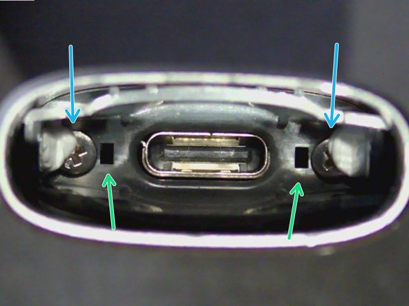

  3. Logitech Spotlight Teardown, Removal of the Retention Clip of the USB-Dongle: crwdns2935265:03crwdnd2935265:01crwdnd2935265:01crwdne2935265:0
    • This is by far the most tricky part. Other teardowns describe this as destructive, however, it is possible to get it out in one piece:
    • Remove the USB-dongle.
    • For that, slip a very small flat-head screwdriver between the aluminium housing and the plastic piece.
    • I was able to wiggle it loose and get under a small lip to then remove it fully
    • Pay attention that two more plastic pieces will fall out. These are not broken of, they are there so the piece you just removed can be clipped in, whilst still having a "smooth" inside for the recepticle and USB-C charging port.

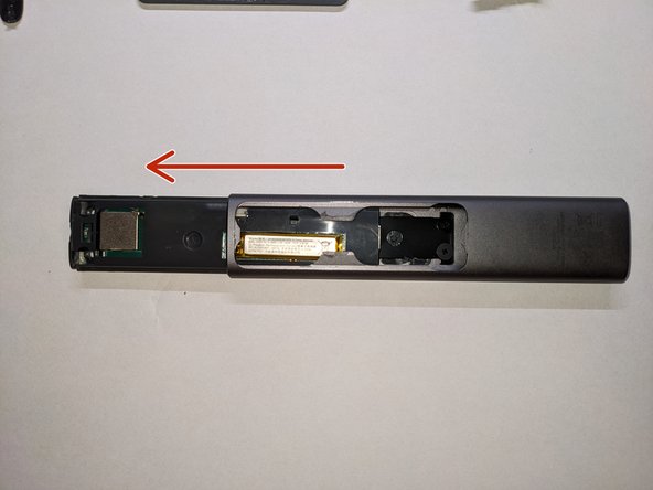

  4. Logitech Spotlight Teardown, Sliding out the Inner Plastic Sled: crwdns2935265:04crwdnd2935265:01crwdnd2935265:03crwdne2935265:0 Logitech Spotlight Teardown, Sliding out the Inner Plastic Sled: crwdns2935265:04crwdnd2935265:02crwdnd2935265:03crwdne2935265:0 Logitech Spotlight Teardown, Sliding out the Inner Plastic Sled: crwdns2935265:04crwdnd2935265:03crwdnd2935265:03crwdne2935265:0
    • To remove the inner plastic sled containing the actual remote, remove the following screws:
    • 2 very small screws at the top.
    • 2 screws where you just removed the USB dongle recepticle.
    • Remember the two plastic pieces that fell out? This is where you later have to place them again
    • When you removed these 4 screws, you are able to slide the inner sled out of the top of the housing.

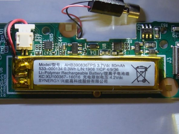

  5. Logitech Spotlight Teardown, Removing the PCB from the Sled: crwdns2935265:05crwdnd2935265:01crwdnd2935265:01crwdne2935265:0
    • The PCB is attached with three screws to the plastic sled. Remove them to get the PCB, including the vibration motor and LiPo battery out.

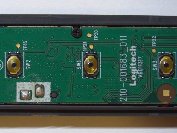

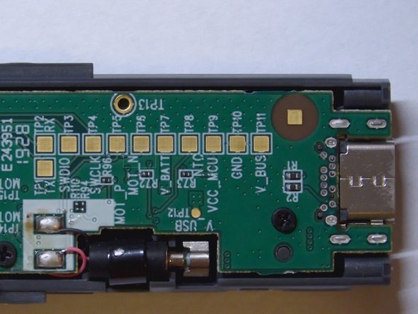

  6. Logitech Spotlight Teardown, Close-Up of the Front of the PCB: crwdns2935265:06crwdnd2935265:01crwdnd2935265:03crwdne2935265:0 Logitech Spotlight Teardown, Close-Up of the Front of the PCB: crwdns2935265:06crwdnd2935265:02crwdnd2935265:03crwdne2935265:0 Logitech Spotlight Teardown, Close-Up of the Front of the PCB: crwdns2935265:06crwdnd2935265:03crwdnd2935265:03crwdne2935265:0
    • On the top of the PCB, there is not much going on except a lot of testing points.
    • You can also see the connection points of the tiny vibration motor.

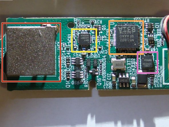

  7. Logitech Spotlight Teardown, Close-Up of the Back of the PCB: crwdns2935265:07crwdnd2935265:01crwdnd2935265:03crwdne2935265:0 Logitech Spotlight Teardown, Close-Up of the Back of the PCB: crwdns2935265:07crwdnd2935265:02crwdnd2935265:03crwdne2935265:0 Logitech Spotlight Teardown, Close-Up of the Back of the PCB: crwdns2935265:07crwdnd2935265:03crwdnd2935265:03crwdne2935265:0
    • This is now the interesting side of the PCB:
    • You can see the 3D antenna here
    • The device is powered by a Nordic Semi N51802. These Nordic Semis are quite common on Logitech peripherials.
    • In addition to that, a SkyWorks 2438T Zigbee and Smart-Energy Module is right next to it.
    • The Gyro and Sensing Unit is a IC268G from InvenSense
    • Last but not least, the LiPo battery is a 80 mAh jobby with 4.2V and 0.3 Wh
    • This is a composite picture. The lighting is so odd, because you should be able to read all the part numbers :)
