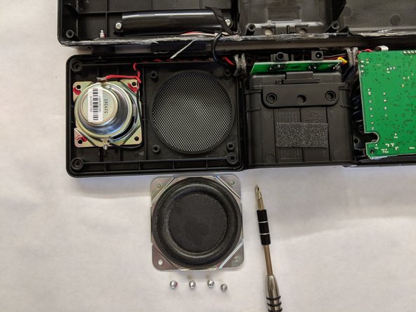

  3. Logitech Pure-Fi Anywhere 2 Inner Speaker Cones Replacement: crwdns2935265:03crwdnd2935265:01crwdnd2935265:02crwdne2935265:0 Logitech Pure-Fi Anywhere 2 Inner Speaker Cones Replacement: crwdns2935265:03crwdnd2935265:02crwdnd2935265:02crwdne2935265:0
    • Identity the speaker cover, and remove four 4.5 mm Phillips #1 screws.
    • Lift up the cone. It should be removed very easily by hand.
  4. Logitech Pure-Fi Anywhere 2 Inner Speaker Cones Replacement: crwdns2935265:04crwdnd2935265:01crwdnd2935265:02crwdne2935265:0 Logitech Pure-Fi Anywhere 2 Inner Speaker Cones Replacement: crwdns2935265:04crwdnd2935265:02crwdnd2935265:02crwdne2935265:0
    • Remove four 5.2mm Phillips #1 screws that are securing the circuit board.
    • Unplug the connecting wire from the circuit board. Carefully lift up the circuit board.
    • Same as step 3, remove four 4.5 mm Phillips #1 screws from the speaker cone.
