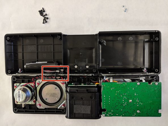

  3. Logitech Pure-Fi Anywhere 2 Dock Adapter Cover Replacement: crwdns2935265:03crwdnd2935265:01crwdnd2935265:02crwdne2935265:0 Logitech Pure-Fi Anywhere 2 Dock Adapter Cover Replacement: crwdns2935265:03crwdnd2935265:02crwdnd2935265:02crwdne2935265:0
    • Use the metal spudger to loosen the front cover to get into the inner part of the device.
    • Metal spudger can damage the internal components of the device such as the motherboard. Make sure to use the metal spudger carefully to avoid any unnecessary damages.
    • Make sure to carefully lift up the front cover from the back cover.
    • There are wires connecting to between battery and the cover.

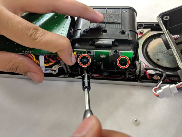

  4. Logitech Pure-Fi Anywhere 2 Dock Adapter Cover Replacement: crwdns2935265:04crwdnd2935265:01crwdnd2935265:02crwdne2935265:0 Logitech Pure-Fi Anywhere 2 Dock Adapter Cover Replacement: crwdns2935265:04crwdnd2935265:02crwdnd2935265:02crwdne2935265:0
    • Identify the small circuit board attached to the dock adapter cover.
    • remove two 2.5 mm Phillips #1 screws at the circuit board.
  5. Logitech Pure-Fi Anywhere 2 Dock Adapter Cover Replacement: crwdns2935265:05crwdnd2935265:01crwdnd2935265:02crwdne2935265:0 Logitech Pure-Fi Anywhere 2 Dock Adapter Cover Replacement: crwdns2935265:05crwdnd2935265:02crwdnd2935265:02crwdne2935265:0
    • Carefully take out the dock adapter cover from the device.
    • It might needs few try to pull out the small circuit board.
    • Take out the broken dock adapter cover and replace with the new one.
