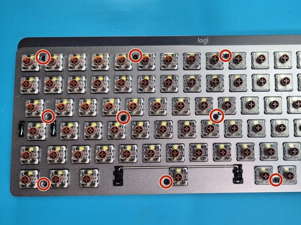

  1. Logitech MX Mechanical Mini Hot Swappable Switches Replacement, Remove keycaps: crwdns2935265:01crwdnd2935265:01crwdnd2935265:01crwdne2935265:0
    • Remove all the keycaps, using a specific tool or by hand.
    • Remove the 15x black screws (photo misses some)

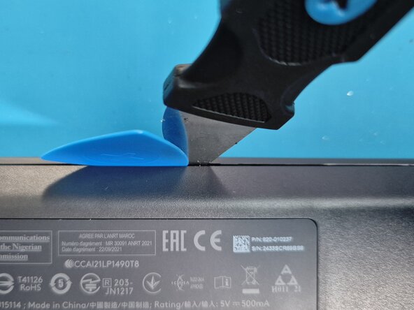

  2. Logitech MX Mechanical Mini Hot Swappable Switches Replacement, Open the keyboard: crwdns2935265:02crwdnd2935265:01crwdnd2935265:02crwdne2935265:0 Logitech MX Mechanical Mini Hot Swappable Switches Replacement, Open the keyboard: crwdns2935265:02crwdnd2935265:02crwdnd2935265:02crwdne2935265:0
    • Open the keyboard using pryer tools.
