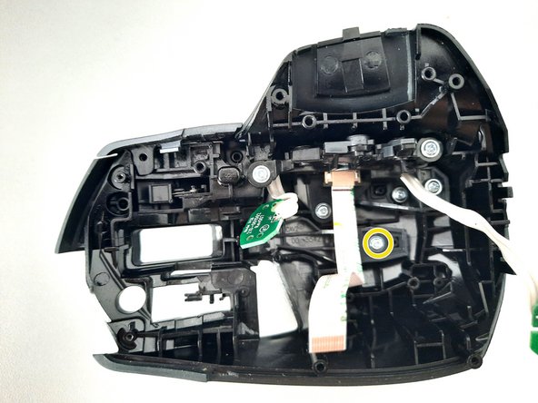

  11. Logitech MX Master 2s Mouse Disassembly, Remove one of the two motherboards: crwdns2935265:011crwdnd2935265:01crwdnd2935265:03crwdne2935265:0 Logitech MX Master 2s Mouse Disassembly, Remove one of the two motherboards: crwdns2935265:011crwdnd2935265:02crwdnd2935265:03crwdne2935265:0 Logitech MX Master 2s Mouse Disassembly, Remove one of the two motherboards: crwdns2935265:011crwdnd2935265:03crwdnd2935265:03crwdne2935265:0
    • Unscrew the three screws from the battery holder and remove the connection to the motherboard.
    • Remove the screws from one of the two electronic boards.
    • Be careful with the electronic tape that joins the two plates, safe it aided by a spunger or other element, without damaging it

There is a very clear example of why one would need to do this. Certain 2s's, including my own, have a fundamental flaw. At some point, the pressing of the thumb-button, the one located below where the thumb is positioned, gradually results in the button getting stuck. For some reason, this results in the mouse movement not registering.
To resolve this issue, you can loosen a screw located button, but this can only be done when the mouse is disassembled, as it is contained within the mouse itself.
