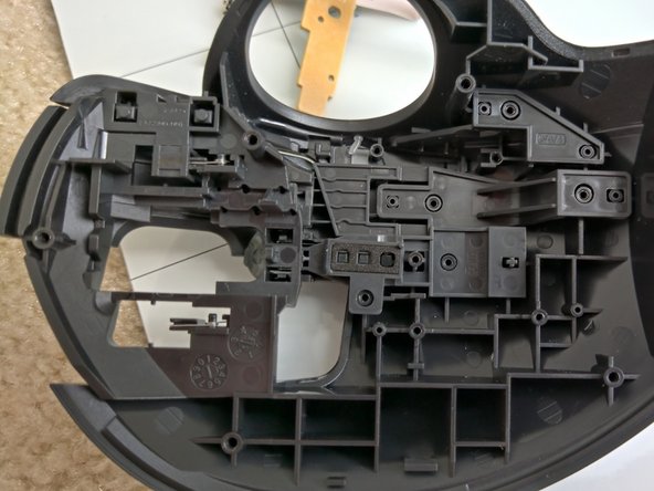

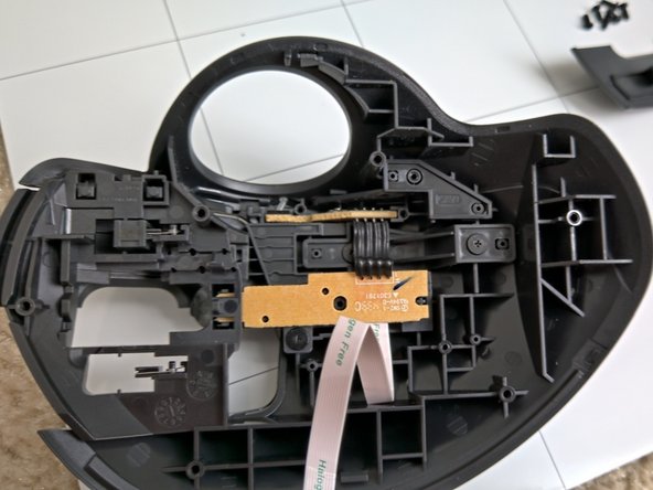

  9. Logitech MX Ergo Disassembly, Disassembly of top half: crwdns2935265:09crwdnd2935265:01crwdnd2935265:03crwdne2935265:0 Logitech MX Ergo Disassembly, Disassembly of top half: crwdns2935265:09crwdnd2935265:02crwdnd2935265:03crwdne2935265:0 Logitech MX Ergo Disassembly, Disassembly of top half: crwdns2935265:09crwdnd2935265:03crwdnd2935265:03crwdne2935265:0
    • The right click lever comes out after the bracket covering the ribbon cable
    • The Right click lever comes out through the front/top of the mouse
    • Then the circuit boards can be removed
  10. Logitech MX Ergo Disassembly: crwdns2935265:010crwdnd2935265:01crwdnd2935265:03crwdne2935265:0 Logitech MX Ergo Disassembly: crwdns2935265:010crwdnd2935265:02crwdnd2935265:03crwdne2935265:0 Logitech MX Ergo Disassembly: crwdns2935265:010crwdnd2935265:03crwdnd2935265:03crwdne2935265:0
    • Under the circuit boards there is three piece that need to come out next
    • The first has one screw and two clear pieces that transmit the light from the circuit board to the outside of the mouse and hole to allow another to pass through it
    • Then the computer selector switch lever can come out the front/top of the mouse
    • After that the connecting light indicator transmitter will fall out and the left click lever can be removed
