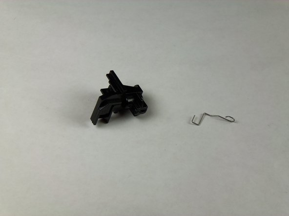

    1. Logitech MBJ58 Mouse Resistance Spring Replacement, Resistance Spring: crwdns2935265:07crwdnd2935265:01crwdnd2935265:02crwdne2935265:0 Logitech MBJ58 Mouse Resistance Spring Replacement, Resistance Spring: crwdns2935265:07crwdnd2935265:02crwdnd2935265:02crwdne2935265:0
      • Grasp the top of the resistance spring and pull it towards yourself, letting the hook slide out of its hole.
    2. Logitech MBJ58 Mouse Resistance Spring Replacement: crwdns2935265:08crwdnd2935265:01crwdnd2935265:01crwdne2935265:0
      • Insert the hooked section of the replacement spring into the corresponding hole on the mount.
