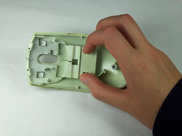

    1. Logitech MBJ58 Mouse Buttons Replacement, Buttons: crwdns2935265:03crwdnd2935265:01crwdnd2935265:02crwdne2935265:0 Logitech MBJ58 Mouse Buttons Replacement, Buttons: crwdns2935265:03crwdnd2935265:02crwdnd2935265:02crwdne2935265:0
      • Locate the two tabs that are protruding from the button assembly.
      • Be careful not to break either of the two tabs by squeezing too hard.
      • Pinch the tabs together to free the buttons.

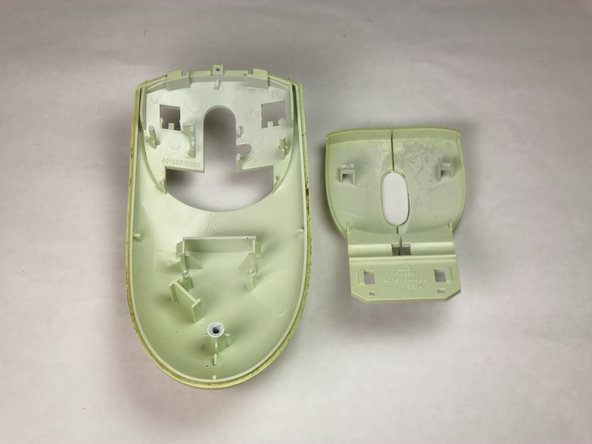

      • Remove the button assembly from the top cover by flipping the top cover upside down and pulling the button assembly downward and away from the top cover.
      • Slide the button assembly out from the top cover through the opening.
      • When fully disassembled, the top cover and the button assembly should look like this.
